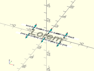

Now, I've factored this marriage out into its own project for general use,
and it's now available here:
https://github.com/jon-gilbert/openscad_attachable_text3d
This project provides an attachable_text3d() module that works pretty
much as you'd expect: given some text, it will measure the dimensions of
that text using fontmetrics, build a boundary box around where that text
should be, and then construct an attachable 3D model of that text using
BOSL2's attachable() and text3d() modules.
