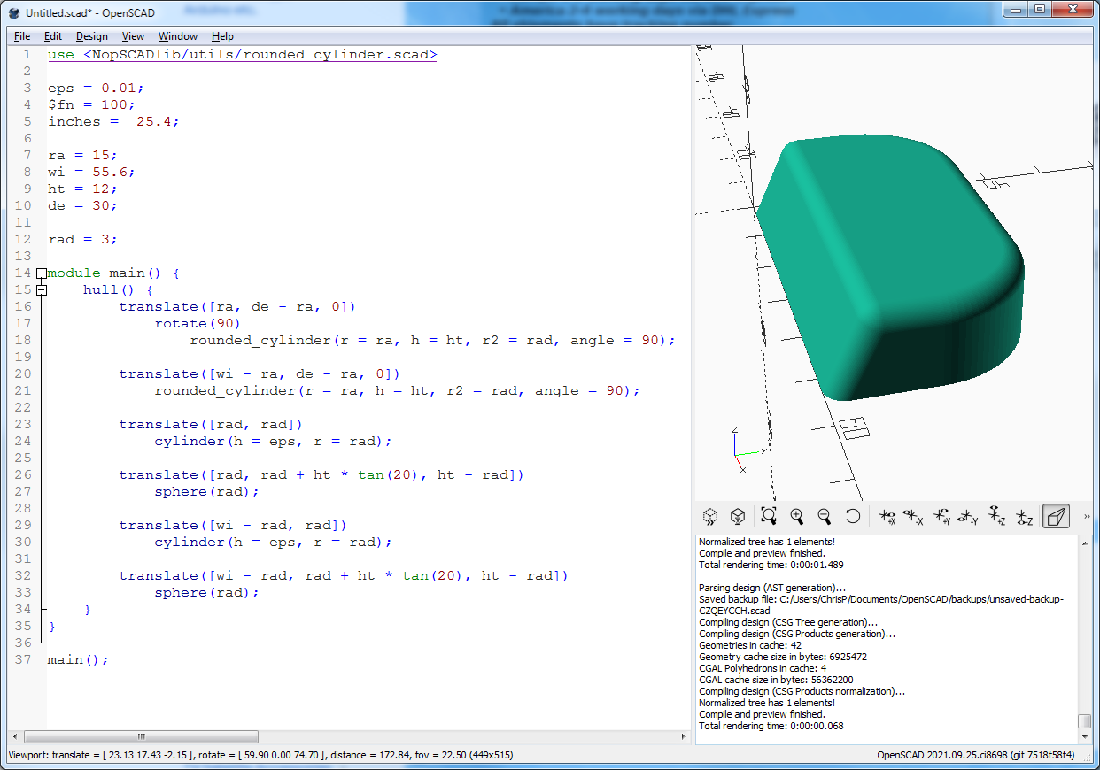

Nophead: I think I've carefully reproduced your code (I've pasted it below). But
my result looks like the attached. Or here:
https://www.dropbox.com/s/ghfr5wbrvn5osx8/RoundedExampleNophead-T.jpg?raw=1
It's as if I'm not using your library, despite earlier examples from it working
a while ago. If I comment out your Use statement the result is unchanged.
Errors shown:
WARNING: undefined operation (undefined - number) in file
RoundExample-Nophead.scad, line 28
WARNING: Ignoring unknown variable 'wi' in file ../RoundExample-Nophead.scad,
line 30
RoundExample-Nophead.scad, line 30
WARNING: Unable to convert translate([undef, 7.36764, 9]) parameter to a vec3 or
vec2 of numbers in file ../RoundExample-Nophead.scad, line 30
Here's my copy of your code:

Mon, Oct 18, 2021 1:46 PM
Corrected my error wi (not vi) = 55.6 and therefore getting closer, but ...

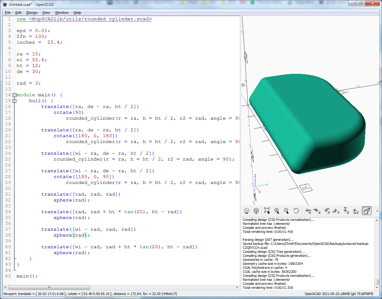

Mon, Oct 18, 2021 2:30 PM
The dominant error was
WARNING: Can't open library 'NOPSCAD1ib/utils/rounded_cylinder.scad'.
I have my library path properly specified and it contains NopSCAD.lib so it was
puzzling. But I eventually resolved it by manually typing in much of your code
image (for which I'd mainly used a OCR tool initially). I think that one or more
of the 'l' (EL) characters had become '1' (ONE).
What font do others use to avoid that ambiguity please? How do i change it?
As usual I see none of my posts, so I hope they have indeed appeared in the
list, as informed by the automated message.

Mon, Oct 18, 2021 2:58 PM
This is the code I used.
use <NopSCADlib/utils/rounded_cylinder.scad>
eps = 0.01;
$fn = 100;
inches =  25.4;
ra = 15;
wi = 55.6;
ht = 12;
de = 30;
rad = 3;
module main() {
hull() {
translate([ra, de - ra, ht / 2])
rotate(90)
rounded_cylinder(r = ra, h = ht / 2, r2 = rad, angle = 90);
        rotate([180, 0, 180])
    translate([wi - ra, de - ra, ht / 2])
        rotate([180, 0, 90])
    translate([rad, rad, rad])
        sphere(rad);
    translate([rad, rad + ht * tan(20), ht - rad])
        sphere(rad);
    translate([wi - rad, rad, rad])
        sphere(rad);
    translate([wi - rad, rad + ht * tan(20), ht - rad])
        sphere(rad);
main();
