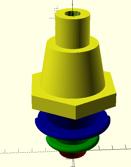

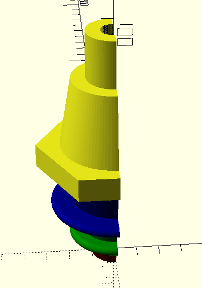

Ok using the function approach works for me, all my sub parts are now
generating completely if invoked separately, and in cutaway when invoked
from the cross section file.
However... :)

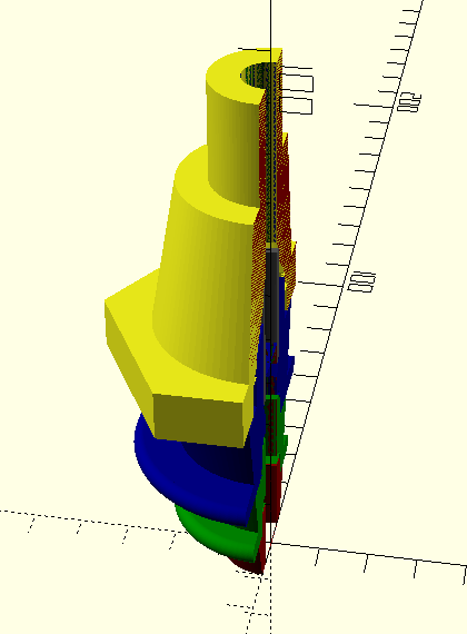

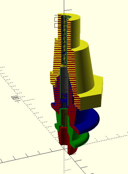

From the cross section file, a preview is taking a while to generate, and
when it's done there are issues.
Rotating or zooming is VERY slow, and it looks like the cross sectioning is
only happening on some angles (??)
Also my torus part is only partially generating. Possibly it is clipping
and the rest are not?
Geometries in cache: 91
Geometry cache size in bytes: 10194352
CGAL Polyhedrons in cache: 22
CGAL cache size in bytes: 96578656
Normalized tree has 2085 elements!
Compile and preview finished.
Total rendering time: 0:00:00.321
See the files Xsection..

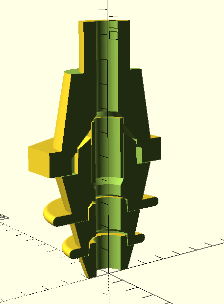

If I render the file, it all looks exactly like it should.
Rotations and zooms are fast and smooth, and everything works as it should,
and it looks good from all angles.
I don't get any warnings in either case.
and when it's done there are issues.
sectioning is only happening on some angles (??)
clipping and the rest are not?
I can't really speak to the performance issue.
Preview gets two common artifacts that are angle-sensitive.
Some of the operations have a "convexity" parameter that hints to the
previewer how complex the object is.  It defaults to 1, which is a
terrible default.  There's almost no penalty to setting it to 10.  The
symptom is that some pieces of the model end up transparent.
The previewer doesn't like it if the camera is inside any part of the
model - including the big cubes that you might be using for clipping,
whether using intersection or difference.  Keep the camera outside those
cubes.  I've never really characterized the misbehavior, but it can lead
to parts of the model appearing and disappearing.
previewer how complex the object is.  It defaults to 1, which is a terrible
default.  There's almost no penalty to setting it to 10.  The symptom is
cubes.  I've never really characterized the misbehavior, but it can lead to

OpenCSG preview draws differences by using graphics operations, so it
draws all the negative objects. If they are too big to fit within the
clipping region faces outside the region are not drawn. That breaks the CGS
operation.
It is best not to subtract massive objects if a smaller one will do the job
or you can use render() to calculate the resulting geometry and just draw
that as a polyhedron. Then you can zoom in as far as you want
