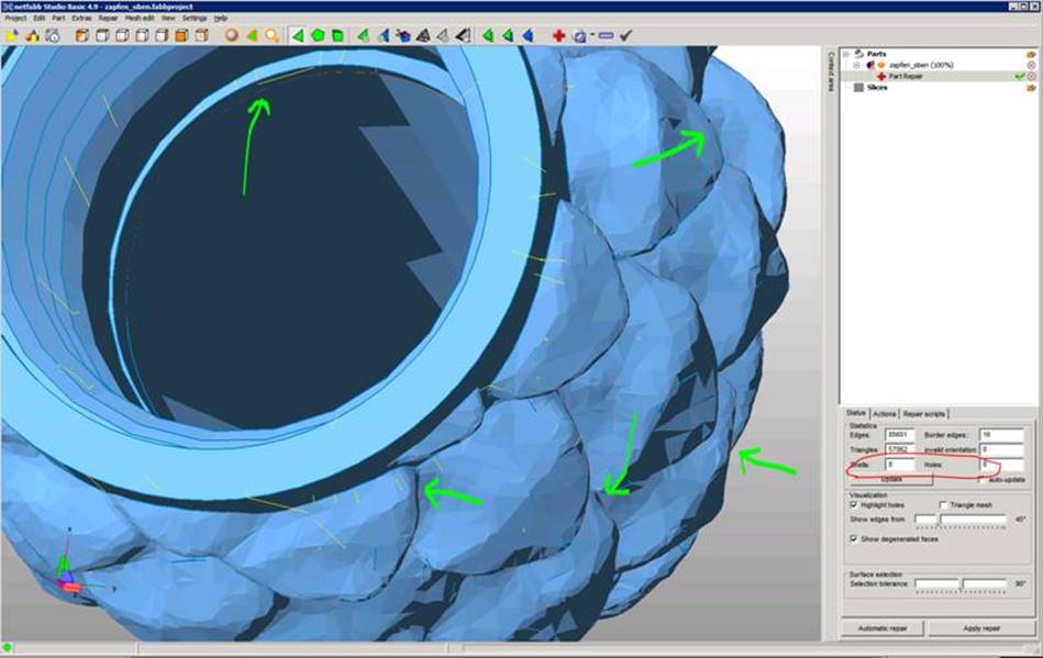

I've attached the fixed file, as an .obj. (via drop box).You can carry
out booleans, now. Here is the .mlx script for Meshlab
<!DOCTYPE FilterScript> <FilterScript>  <filter name="Merge Close Vertices"/>  <filter name="Remove Zero Area Faces"/>  <filter name="Remove Duplicate Faces"/>  <filter name="Remove Unreferenced Vertices"/>  <filter name="Repair non Manifold Edges by removing faces"/>  <filter name="Close Holes">     <Param type="RichInt" value="5000" name="MaxHoleSize"/>     <Param type="RichBool" value="false" name="Selected"/>  </filter> </FilterScript>
Here's the before and after parameters for the shape.
start-shape <shape> mesh v: 28538 t: 57068 | raw_mesh v: 28538 t: 57068
end shape <shape> mesh v: 28182 t: 56348 | raw_mesh v: 28182 t: 56348
I expect the shape could be significantly simplified.
I've also added the error file, which shows the position of where the
faults are, mainly in the internal thread area. The pyramidal type
shapes, are just the shapes for the markers, they do not represent the
actual profile of the faces in error.
On 29/05/2026 14:27, Raymond West via Discuss wrote:
I'm developing my file fixer further. There appears to be 140
degenerate triangles in that file. I know where they are, am getting
co-pilot to write the code for meshlab to auto fix them.

I could resolve the problem with a newer version from OpenScad which
in deed has the manifold feature within the settings.
This works now for me.
yours Karl

I looked at the stl, it has lots of things wrong.
Multiple shells (8),(likely due to), 8 holes (the red bits (see
green arrows for just a few) and degenerate faces (yellow lines).
CGAL wont process that.
It looks like a 3D scan, they are often full of problems.
