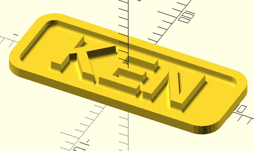

I'm hoping to create a simple pattern for a casting a couple of brass
nameplates. I would like to produce it as an stl for fdm printing. There
are a few problems. 1) I've created a 3d design approximating to the
desired size, but when extruding, there needs to be a draft angle of
about 3 degrees for each letter and the frame. 2) there needs to be a
fillet at the base of each character for easy pattern removal. 3)
ideally, it would be nice to individually adjust the width of the
strokes  of the letters. The code, so far, is listed below.
As the lettering is simple, then I am wondering if it may be easier to
create a profile for a cross section, including the fillet, and extrude
a length, cut up and rotate and place accordingly. (it would be ten
pieces and the frame).  I think that I could create the fillets, if I
could get the draft angle on the eletter strokes, by differencing into a
cube, and applying Minkowski with a small sphere, and differencing back
again.
Machining from solid is simpler, I use a profiled round-ended cutter to
get the draft angle and fillet in one pass, I could almost write the
g-code by hand for that....
Any suggestions? (being a bit of a Luddite, I am not going to be using
bos2l 😳 )

You can always minkowski the text with a pseudo traffic-cone shape.
module rrect(size, r) {
hull() {
for (x = [-1,1], y = [-1,1])
translate([x*(size.x/2-r), y*(size.y/2-r)])
circle(r=r);
module plate(size, r, wall, base, height) {
linear_extrude(height=height) {
rrect(size, r);
rrect(size-2*[wall,wall], r-wall);
linear_extrude(height=base) {
rrect(size, r);
module trumpet_horn(fillet, height, ang, n) {
tanx = fillet / cos(ang);
xoff = (height-fillet) * tan(ang);
cp = [tanx+xoff, fillet];
path = [
[0,height],
for (i = [0:1:n])
let( a = 180 + ang + (90-ang) * (i/n) )
cp + fillet * [cos(a),sin(a)],
[0,0]
rotate_extrude() polygon(path);
module name(text, fillet, height, ang, n) {
minkowski() {
translate([0,0,-0.1]) {
linear_extrude(height=0.1, center=false)
text(text, font="Liberation Sans:style=Bold", size=50, valign="center",halign="center");
trumpet_horn(fillet, height, ang, n);
module plaque(text, height, fillet, ang) {
translate([0,0,2])
name(text=text, fillet, height, ang, n=3);
plate(size=[220,90], r=20, wall=10, base=2, height=10);
plaque("KEN", height=10, fillet=3, ang=3);

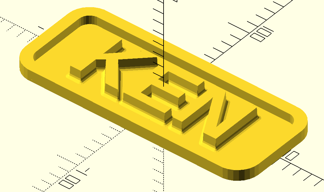

I realized after posing that the the plate itself needed filleting:
hull() {
circle(r=r);
module plate(size, r, wall, base, height, fillet, ang=3, n=3) {
rrect(size, r);
minkowski() {
translate([0,0,base-0.1]) {
linear_extrude(height=0.1) {
rrect(size-1.9*[wall,wall], r-0.95wall);
rrect(size-2
trumpet_horn(fillet, height-base, ang, n);
rrect(size, r);
module trumpet_horn(fillet, height, ang=3, n=3) {
path = [
[0,height],
for (i = [0:1:n])
[0,0]
module name(text, fillet, height, ang=3, n=3) {
minkowski() {
module plaque(text, height, fillet, ang=3) {
translate([0,0,2])
plate(size=[220,90], r=20, wall=10, base=2, height=10, fillet=fillet, ang=ang);

Thanks Revar,
Just what I needed.  I realise now that I created a sort of x y problem
for myself, having always used a sphere for rounding edges with
Minkowski, I'd completely forgotten that other solids were possible,
never mind hull for corner rounded squares. 🙁
Best wishes,
Ray

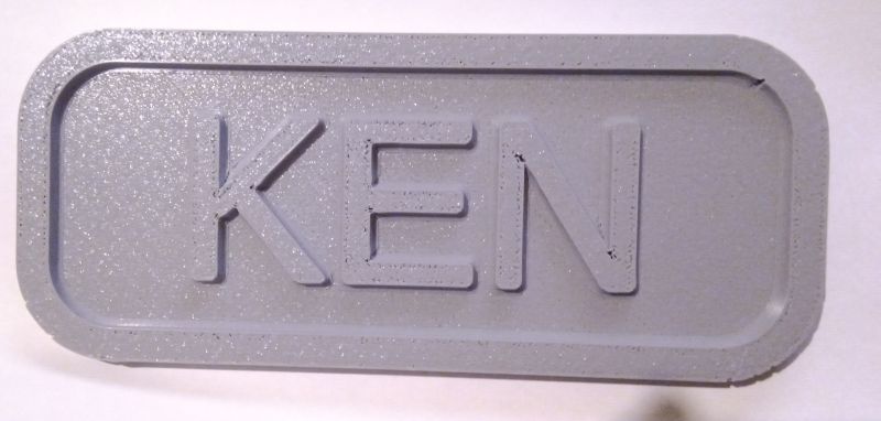

I made it parametric, with customizer, and did a quick test print. -

I made it parametric, with customizer, and did a quick test print. - On 03/05/2024 10:33, Raymond West via Discuss wrote: > > Thanks Revar, > > Just what I needed.  I realise now that I created a sort of x y > problem for myself, having always used a sphere for rounding edges > with Minkowski, I'd completely forgotten that other solids were > possible, never mind hull for corner rounded squares. 🙁 > > Best wishes, > > Ray > >
