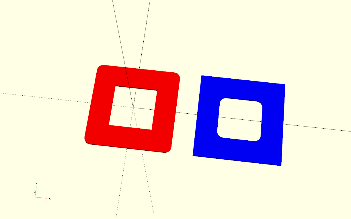

Sat, Dec 24, 2016 12:31 PM
$fn = 32;
module shape()
square(40, center = true);
square(20, center = true);
color("red") offset(3) offset(-3) shape();
translate([50, 0, 0])
color("blue") offset(-3) offset(3) shape();
On 24 December 2016 at 12:18, jon jon@jonbondy.com wrote:
If either of you (nop head, Parkinbot) could provide a small example, I
would appreciate it.
On 12/24/2016 7:15 AM, nop head wrote:
If you do a negative and a positive offset() with the same parameter the
result will be identity.
No it will round the convex or concave corners (depending on the order)
with a radius equal to the offset. I use it regularly.
On 24 December 2016 at 12:08, Parkinbot rudolf@parkinbot.com wrote:
Next time please give a full code example.
$fn = 32; module shape() difference() { square(40, center = true); square(20, center = true); } color("red") offset(3) offset(-3) shape(); translate([50, 0, 0]) color("blue") offset(-3) offset(3) shape(); ​ On 24 December 2016 at 12:18, jon <jon@jonbondy.com> wrote: > If either of you (nop head, Parkinbot) could provide a small example, I > would appreciate it. > > On 12/24/2016 7:15 AM, nop head wrote: > > >If you do a negative and a positive offset() with the same parameter the > result will be identity. > > No it will round the convex or concave corners (depending on the order) > with a radius equal to the offset. I use it regularly. > > On 24 December 2016 at 12:08, Parkinbot <rudolf@parkinbot.com> wrote: > >> Next time please give a full code example. >> If you do a negative and a positive offset() with the same parameter the >> result will be identity. >> > > > _______________________________________________ > OpenSCAD mailing list > Discuss@lists.openscad.org > http://lists.openscad.org/mailman/listinfo/discuss_lists.openscad.org > >
Sat, Dec 24, 2016 11:19 PM
runsun, you are right. It is obviously not identity (only the initial
example). So what do you do, if you want to have inner and outer edges
rounded?

CA
Sun, Dec 25, 2016 12:22 AM
rounded?
You apply both techniques at once.
module rectangle_with_hole(a = 12, b = 16, th = 4)
square([a,b],center=true);
square([a-2th,b-2th],center=true);
$fn = 30;
rad = 1.5;
// causes outer loop rounding
offset(r=rad)
offset(r=-rad)
// causes inner loop rounding
offset(r=-rad)
offset(r=rad)
rectangle_with_hole();
