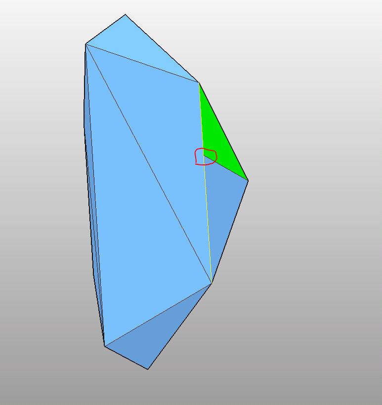

I've been reading about manifold shapes, and welds, and such, and was able to
build 35 Elite ships that export without incident.
I've got 3 - the Asp here is one of them, and I can't get it to survive
being unioned with a cube. It becomes non-manifold.
I've checked with the "Thrown together" view for incorrect windings, and
there is none.
I've also checked that there's no polygons meeting midway along a long
edge... they all meet at vertices.
So as of this point, I've run out of things to check or try - if anyone
could confirm the shapes correct I can stop trying to fix it!
Many thanks!

That is the problem, can't have a vertex in the middle of an edge.

That is the problem, can't have a vertex in the middle of an edge. > -----Original Message----- > From: Discuss [mailto:discuss-bounces@lists.openscad.org] On Behalf Of SarahC > Sent: Sun, 8 Sep 2019 13:11 > To: discuss@lists.openscad.org > Subject: [OpenSCAD] My Asp exports as manifold, but the polyhedron breaks with Union. > > I've been reading about manifold shapes, and welds, and such, and was able to > build 35 Elite ships that export without incident. > > I've got 3 - the Asp here is one of them, and I can't get it to survive > being unioned with a cube. It becomes non-manifold. > > I've checked with the "Thrown together" view for incorrect windings, and > there is none. > > I've also checked that there's no polygons meeting midway along a long > edge... they all meet at vertices. > > So as of this point, I've run out of things to check or try - if anyone > could confirm the shapes correct I can stop trying to fix it! > > Many thanks! > > > //----------------------------------------- > polyhedron( > > points=[ > [115, -10, 15], // 0 > [50, -10, 97], // 1 > [90, 16, 27], // 2 > [-50, -10, 97], // 3 > [-115, -10, 15], // 4 > [-90, 16, 27], // 5 > [65, -10, -103], // 6 > [98, -30, 37], // 7 > [-98, -30, 37], // 8 > [-65, -10, -103], // 9 > [0, 30, -11], // 10 > [0, 20, -103], // 11 > [18, -10, -103] // 12 > ], > faces=[ > [7,0,6], // a > [8,3,1,7], // b > [7,6,9,8], // c > [6,2,10], // d > [5,9,10], // e > [11,6,10], // f > [11,10,9], // g > [2,1,3,5,10], // h > [6,11,9,12], // i > [9,5,4], // j > [8,9,4], // k > [3,8,4], // l > [4,5,3], // m > [1,2,0], // n > [0,7,1], // o > [0,2,6] // p > ] > ); > > > translate([0,10,50]) cube(30, center=true); > > > > -- > Sent from: http://forum.openscad.org/ > > _______________________________________________ > OpenSCAD mailing list > Discuss@lists.openscad.org > http://lists.openscad.org/mailman/listinfo/discuss_lists.openscad.org --- This email has been checked for viruses by AVG. https://www.avg.com

Yes, that works. Email is good for inline images BTW, the forum 'changed' and just includes a link
to the image.
For debugging this stuff it is also handy to set View/Show-edges, in case you didn't see that

The other replies to your question are correct, you have a vertex in the
middle of an edge, causing the polyhedron to be non-manifold. The actual
bug here is that such issues are not detected by OpenSCAD before export,
it will result in an STL that cannot be safely imported later. In other
words, if you suspect no issue and export the polyhedron (without the
union), and later import it and then try some boolean operation...
import("Asp.stl");
it will cause a warning:
WARNING: Object may not be a valid 2-manifold and may need repair!
The best fix is to make sure the polyhedron is correct in the first
place. However, if the STL came from some other source than your own
code you might be out of luck using it. One way of fixing such issues
without access to the source code is to run one of the repair utilities
that exist, for example  "polyfix" that I wrote. It is part of the
AngelCAD package https://arnholm.github.io/angelcad-docs/ . When used on
this case, the problem is fixed:
C:\work\STL>polyfix Asp.stl
Parameters:
input_file = Asp.stl
iteration 0: vertices=63 faces=21
warning: nonmanifold edges: uc(1)=63
merged 50 vertices
split 1 face
total changes=51
no warnings
iteration 1: vertices=13 faces=22
total changes=0
no warnings
Summary:
polyhedron 0: vertices=13 faces=22 : no warnings
Writing: Asp_1.stl
... polyfix finished, time used: 0d 00h 00m 01s
In short, the vertex in the middle of the edge is detected, the edge and
relevant face(s) are split, creating a proper 2-manifold polyhedron. You
can then use the repaired STL in OpenSCAD without the warning:
import("Asp_1.stl");
On 2019-09-08 05:10, SarahC wrote: > I've been reading about manifold shapes, and welds, and such, and was > able to > build 35 Elite ships that export without incident. > > I've got 3 - the Asp here is one of them, and I can't get it to survive > being unioned with a cube. It becomes non-manifold. The other replies to your question are correct, you have a vertex in the middle of an edge, causing the polyhedron to be non-manifold. The actual bug here is that such issues are not detected by OpenSCAD before export, it will result in an STL that cannot be safely imported later. In other words, if you suspect no issue and export the polyhedron (without the union), and later import it and then try some boolean operation... ---- import("Asp.stl"); translate([0,10,50]) cube(30, center=true); ---- it will cause a warning: WARNING: Object may not be a valid 2-manifold and may need repair! The best fix is to make sure the polyhedron is correct in the first place. However, if the STL came from some other source than your own code you might be out of luck using it. One way of fixing such issues without access to the source code is to run one of the repair utilities that exist, for example "polyfix" that I wrote. It is part of the AngelCAD package https://arnholm.github.io/angelcad-docs/ . When used on this case, the problem is fixed: ---- C:\work\STL>polyfix Asp.stl Parameters: input_file = Asp.stl iteration 0: vertices=63 faces=21 warning: nonmanifold edges: uc(1)=63 merged 50 vertices split 1 face total changes=51 no warnings iteration 1: vertices=13 faces=22 total changes=0 no warnings Summary: polyhedron 0: vertices=13 faces=22 : no warnings Writing: Asp_1.stl ... polyfix finished, time used: 0d 00h 00m 01s ---- In short, the vertex in the middle of the edge is detected, the edge and relevant face(s) are split, creating a proper 2-manifold polyhedron. You can then use the repaired STL in OpenSCAD without the warning: ---- import("Asp_1.stl"); translate([0,10,50]) cube(30, center=true); ---- Carsten Arnholm
