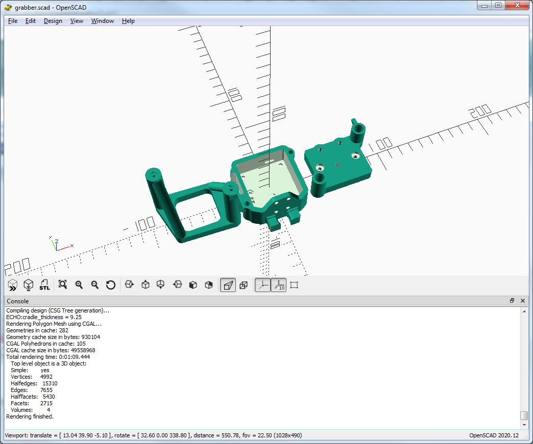

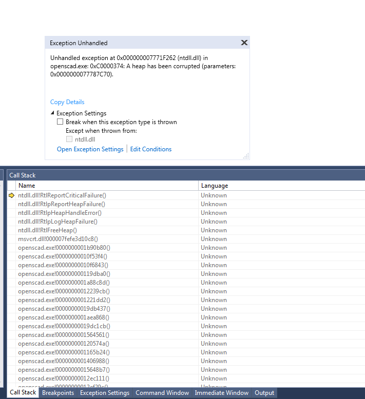

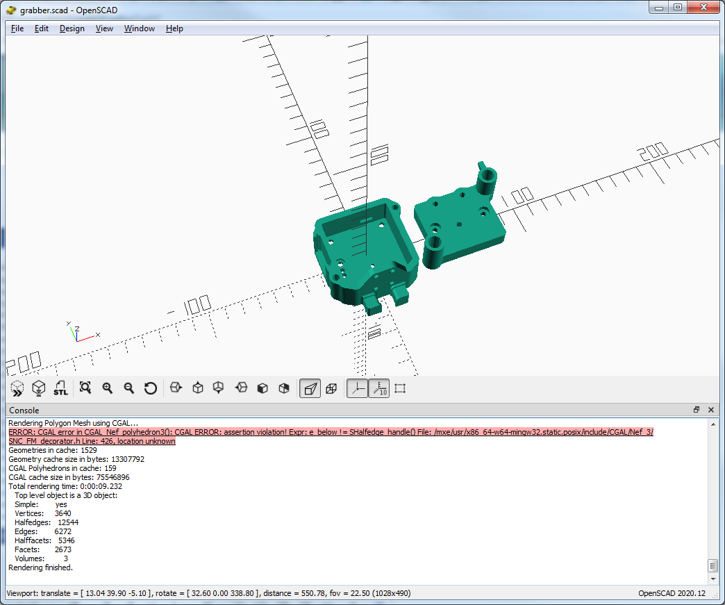

The first time I ran this I got a heap corruption crash but I haven't been
able to reproduce it. I did F5 followed by F6 on a shape with intersecting
cylinders and it gave a CGAL error due to the grid snap. So I cleared the
cache to do another F6, which normally works. I think perhaps I managed to
clear the cache before the first F6 had finished because it doesn't stop on
the CGAL error. However I can't do it again, so it might be a race
condition.
This is F6 after F5, with the offending object missing.
The is flush cache followed by F6. It doesn't give the CGAL error but the
STL has self intersections.
Cylinders of different diameters meeting at an angle seems to be impossible
in OpenSCAD because it is hard to avoid close but not touching vertices
somewhere around the intersection.
