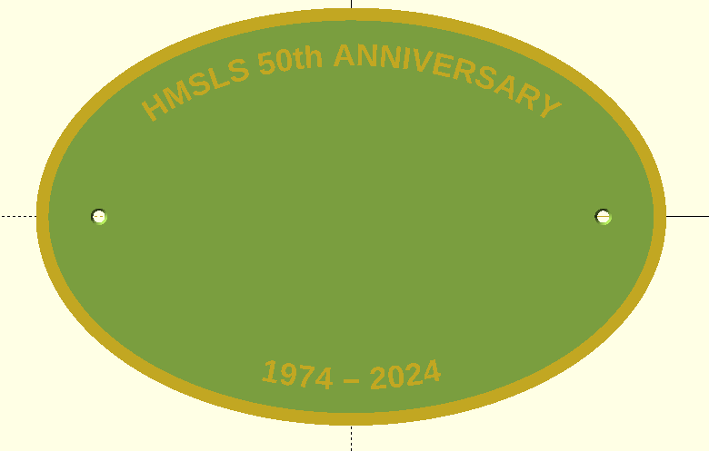

It looks like I sent this only to Jordan instead of the whole list.  This
shows how to place the text without a lot of effort
Yeah, if you want kerning you're on your own.  But (1) most people aren't
that attuned to text spacing so they probably won't notice the lack of
kerning and (2) kerning may need to be different for text on a curved path
anyway.  Just getting the right basic spacing for a proportionally spaced
font is going to be enough for most people.
I rewrote OP's code.  First of all, it offended me that things weren't
parallel.  Two non-circular ellipses aren't parallel, so this meant the
border varied in thickness.  And if the text is on an ellipse it isn't
parallel to the border.  You need to use offset() operations to make them
parallel. Then I used path_text() to place the text. I also replaced the
hyphen with a unicode en-dash.  The hyphen is too short and looks bad.  I
think it looks fine without kerning, but if you disagree, you can use the
kern parameter to tweak the spacing from this, which is a lot easier than
getting straight to this layout with trial and error.
include <BOSL2/screws.scad>
$fa = 1;
$fs = 0.4;
size = [120, 78];  // size inside the border of the model
border=5;
text_inset=18;
font="Liberation Sans:style=Bold";
linear_extrude(height=2) offset(border)ellipse(size);
up(1) linear_extrude(height=2) ellipse(size);
up(1) xflip_copy()
right(100)screw_hole("M3", length=2, head="flat",anchor=TOP);
path_top = [for(theta=[180:-1:0]) [size.xcos(theta), size.ysin(theta)]];
inset_path_top=path3d(offset(path_top, delta=-text_inset));
path_text(inset_path_top, text="HMSLS 50th ANNIVERSARY",center=true,
size=9, normal=UP, thickness=2, offset=1,
font=font,textmetrics=true);
path_bot = [for(theta=[180:1:360]) [size.xcos(theta), size.ysin(theta)]];
inset_path_bot=path3d(offset(path_bot, delta=text_inset));
path_text(inset_path_bot, text="1974 – 2024",center=true, size=9,
font=font,textmetrics=true,valign="top");
On Sun, Aug 11, 2024 at 6:28 AM Jordan Brown openscad@jordan.maileater.net
I didn't dig into your example, but is there a reason you can't do this
directly with the path_text() module?  Assuming you use a dev version and
enable textmetrics, you will get proper text spacing (but no ligatures).
Probably also no kerning, which might be the source of the IV complaint.
For those not familiar with typography, ligatures are the substitution of
certain sequences with single glyphs - for instance, replacing f f i with a
single glyph that connects the three. Kerning is the related technique of
adjusting spacing to account for the different shapes of the glyphs (vs a
simple box model) - for instance, pulling AV together, possibly even
overlapping their boxes, to avoid putting the white space at the top right
of the A next to the white space at the bottom left of the V.
The easy way to lay out text does neither of these things.
Forming the text to a curve makes the picture more complicated - I didn’t
look at the OP’s example, but IV at the bottom of a curve will put the
bottoms of the two letters way far apart.
Quite possibly the only practical remedy is to manually adjust the spacing
until it looks right.

Adrian, many thanks for the re-write of my code, I had never seen things
like up, xflip, normal, etc. used before. They certainly make it easier
to use and understand.
Also, the use of screw_hole- another part of BOSL2 I hadn't noticed. I
had actually written a module specifically to create m3 countersunk
screw holes (and m2 and m4 and m5- four separate modules....)- following
your example I can now dispense with all that!
And I like the more accurate oval text (though I don't really understand
it), I have now used that in my plaque, it looks much better than my
attempts.
Next step is to find a pla that is close to Brunswick Green for the body
of the plaque, then I can have a go at printing it multi-colour with my Xl.
