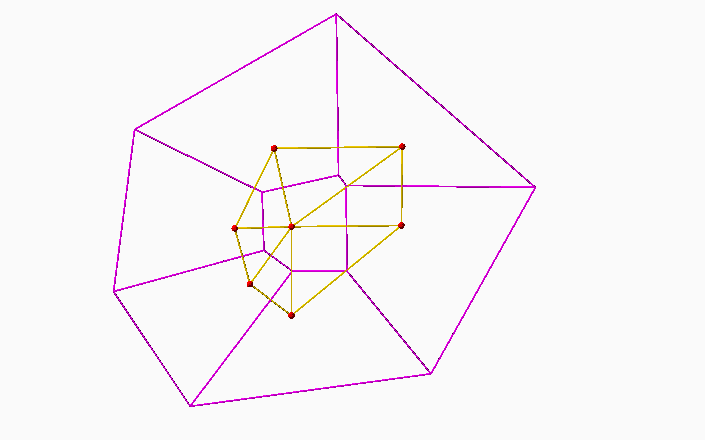

I have a data structure built from a vertices-and-faces description (VNF)
that ensures that all local adjacencies can be found in constant time.
It is constructed in O(n log n) (involves sorting and local searches) and
the adjacency access functions are inspired by the quad-edge structure
without the dual access functions. It requires a VNF representing a
topological 2-manifold without border. So to compute the VD from the DT I
needed to add a "border face", a face with a consistent widing representing
the outside world of the DT. The resulting VNF of the DT is then a
topological 2-manifold without border and easily dualizable (although a
strict dual would have a vertex associated to the border face). To cope
with the infinity edges of the VD far away vertices are added to the list
of circumcenters. In order to have closed VD cells, the far away vertices
are linked with additional edges and thus the VD itself may be represented
as a topological 2-manifold without border. The following picture shows the
results with the extra vertices of the VD closer enough to the point mass
for sake of illustration.
[image: Delaunay&Voronoi.PNG]
That data structure also makes it possible to implement the so-called
subdivision methods (like Catmull-Clark, Doo-Sabin and Loop's algorithm)
for VNFs without border with a worst case order of O(n log n). Its space
requirements are O(n).

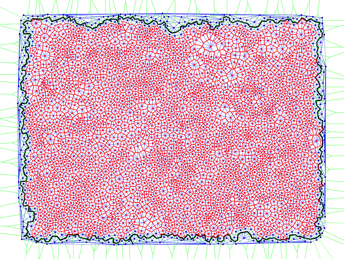

For your proposed search - how would you sort the half edges? ...
Obviously more sophisticated data structures have advantages, but sorting by
index in the point list works just fine, since the half edge that pairs with
(a,b) is (b,a).  Generation of something like:
http://forum.openscad.org/file/t2140/delaunay_voronoi.png
Is dominated by time spent on generating the triangulation.  (I was a little
surprised about the loose triangle on the upper left, but it makes sense
that that can happen.)

I tried to implement tri_delaunay and tri_delaunay2voronoi. <http://forum.openscad.org/file/t1825/tri_vro.jpg> // https://github.com/JustinSDK/dotSCAD/blob/master/src/experimental/tri_delaunay.scad use <experimental/tri_delaunay.scad>; // https://github.com/JustinSDK/dotSCAD/blob/master/src/experimental/tri_delaunay2voronoi.scad use <experimental/tri_delaunay2voronoi.scad>; use <hull_polyline2d.scad>; points = [for(i = [0:20]) rands(-100, 100, 2)]; color("black") for(p = points) { translate(p) circle(2); } %draw(tri_delaunay(points, ret = "TRI_SHAPES")); d = tri_delaunay(points, ret = "DELAUNAY"); #draw(tri_delaunay2voronoi(d)); module draw(pointsOfTriangles) { for(t = pointsOfTriangles) { hull_polyline2d(concat(t, [t[0]])); } } ----- https://openhome.cc -- Sent from: http://forum.openscad.org/
KS
// https://github.com/JustinSDK/dotSCAD/blob/master/src/experimental/tri_delaunay.scad https://github.com/JustinSDK/dotSCAD/blob/master/src/experimental/tri_delaunay.scad
// https://github.com/JustinSDK/dotSCAD/blob/master/src/experimental/tri_delaunay2voronoi.scad https://github.com/JustinSDK/dotSCAD/blob/master/src/experimental/tri_delaunay2voronoi.scad
color("black")
for(p = points) {
translate(p)
circle(2);
https://openhome.cc https://openhome.cc/
