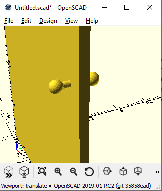

For instance:
$fs=0.2;
module door() {
    h = 78;
    w = 36;
    t = 1.5;
    handle_h = 30;
    handle_inset = 3;
    cube([w, t, h]);
    translate([w-handle_inset, 0, handle_h])
        rotate([90,0,0])
        handle();
    translate([w-handle_inset, t, handle_h])
        rotate([-90,0,0])
        handle();
module handle() {
    shaft_h = 2;
    cylinder(h=shaft_h, d=1);
    translate([0,0,shaft_h])
        sphere(d=2);
door();
Here's the process I used:
  • I want to make a door.  ("module door() {}")
  • The door is a rectangle with certain dimensions ("h=... w=... t=...
    cube(...)");
  • And let's actually render something.  ("door();")
  • I need a handle on the front side.  I'll design a handle so that the
    base of the handle is at [0,0,0] and it extends up into +Z, so that
    means that it needs to be translated up to the right place
    ("handle_h = ... handle_inset = ... translate(...)" and rotated into
    the right orientation ("rotate(...)").
  • But I don't want to design the handle now, because I'm going to want
    to design it once and place it twice.  ("handle( )")
  • Let's design the handle.  ("module handle() {  }")
  • The only tricky part is the relationship between the cylinder and
    the sphere.  Let's measure from the face of the door to the center
    of the sphere.  (contents of the module)
  • OK, that's a handle on the front.  Now for a handle on the back.  It
    needs to be translated to the same place, but on the other side
    ("translate([..., t, ...])"),
  • The back handle needs to be pointed the other direction.
    ("rotate([-90,...])".
More likely, I'd make the handle be a child of the door module, so that
I could have doors with different kinds of handles.  A fully-fleshed out
example would have more complex rules for the handle, to allow for
asymmetric handles and positioning them on the left and right sides of
the door.
OK, in some ways that's wildly more complex than a "place boxes and
spheres in space" model.  But when I realize that doors are actually 2"
thick rather than 1.5" thick, I change one parameter and it all still works.
FreeCAD claims to have this kind of parameterization, but so far (in
maybe a half hour of playing with it) it's defeated me.  I can't even
figure out how to make two spheres that will stay next to each other.
In OpenSCAD that's:
$fn=100;
r1 = 5;
r2 = 10;
sphere(r1);
translate([0,0,r1+r2])
    sphere(r2);
