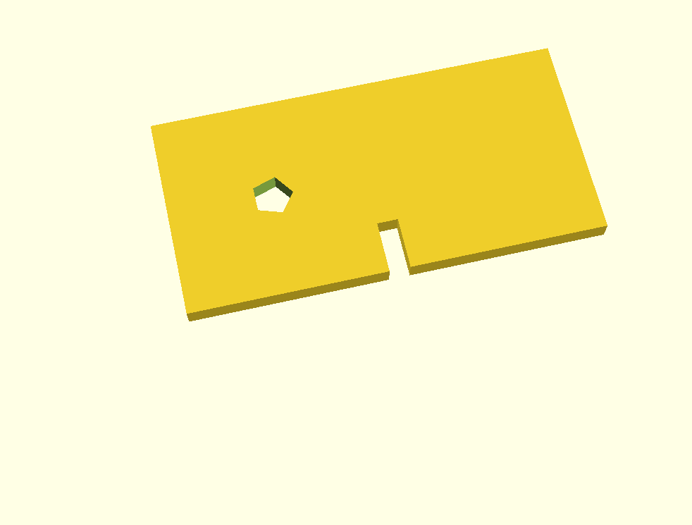

Your "plate with crack represented as STL" is not how that surface will
actually be represented in an STL file.
cube([20, 10, 1]);
translate([10, 0, 0])
cube([1, 5, 3], center = true);
This is how the triangles appear in the STL file.
Here I import the STL file and do CSG on it.
import("cracked_plate.stl");
translate([5,5,-1]) cylinder(h = 3, r = 1);
STL can represent manifold meshes unambiguously and you
can then do boolean ops on them.

No the above shows that you are incorrect. You don't seem to able to
comprehend how a triangle mesh can represent a 3D object. There is no
information lost writing an STL file and reading again unless the vertices
can't be represented accurately in floats.

If as a I said many times before "if the conversion to floats does not
collapse vertices and the object is 2-manifold then the STL file can be
read back into OpenScad and operated on with CSG". There isn't  any missing
topological information as you keep suggesting. It is implicit in the list
of triangles. When it is read in you can make a list of unique vertices and
a list of triangle edges that connect them. You can then convert to
OpenScad's internal representation just the same as the polyhedron module
can given a list of points and faces linking those points. The result is a
first class OpenScad object. It has lost nothing being converted to STL and
back except perhaps some numerical accuracy.

I don't understand how this is a strawman argument.
The central point is of contention seems to be whether a simple list of
triangles can convey topology implicitly or whether extra topological
information is required.
My argument is that as long as the mesh is 2 manifold and as long as
distinct vertices are numerically distinct and identical vertices are
numerically identical in the file then all the edge information is not
needed. You can reconstruct the edge information by building a table of
unique vertices and connecting them with the triangle edges they belong to.
You should then find any pair of vertices should either not be connected or
connected by two triangle edges into opposite directions. You then know
exactly how the triangles are connected, so you know the complete surface
topology.
Your argument is that topology is lost by exporting to STL and when
reimported you cannot do CSG operations. You supported it by two examples
but neither actually show this. The crack example has a diagram that
suggests the STL file will ignore the crack. The diagram states  "vertices
5 & 7" have identical coordinates. So I replied it was non manifold. Then
you said "The example is manifold and the vertices 5 and 7 are distinct
because I told you they are, and it is plain to see." Well its plain to see
the vertices are distinct and therefore can't have identical coordinates.
If they actually have identical coordinates the object is not 2 manifold
and you won't be able to do CSG on it anyway, regardless of whether it is
written to STL or not. It isn't something that can physically exist and I
can't find a way of making it in OpenScad. I might be able to make a crack
so thin it gets lost when converted to float but I have always said that
STL only works when the vertices are numerically distinct in the STL file.
Your second example simply shows loss of numerical accuracy converting
OpenScad's internal representation to strings and back. It also shows
OpenScad can't difference two objects that are nearly identical but not
quite. It doesn't show writing to STL  loses some topological information.
You can in fact do CSG on the imported version.  You just can't difference
it with the non-imported version.
STL files only go wrong in the real world because many programs write
non-manifold objects into them or the readers and writers are not careful
with truncation and rounding. You will still get problems with other file
formats that do store the topology explicitly if the topology is not
manifold if you try to do CSG with it in OpenScad. As, has been
demonstrated Ronaldo, it doesn't like self intersecting shapes.
