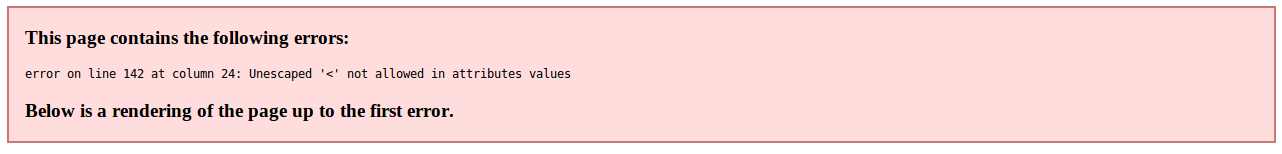

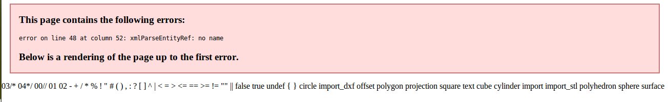

The forum pages are giving me errors.

Try right-click/Save-As
