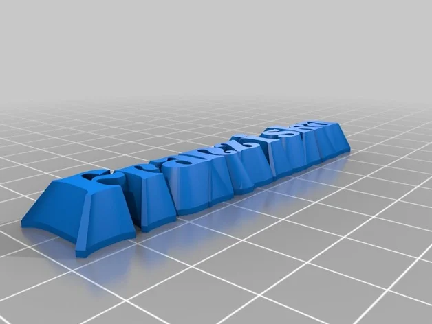

I'm trying to create 3D model to print a stamp. I started with Inkscape SVG
file with some text converted in single path in it. Then I convert it into
DXF format with plugin for Inkscape. Then I import it into OpenSCAD and
extrude the stamp. The problem is that the stamp should have a cone-like
shape. The letters must become thick at the bottom. I did't find the way to
this using extrude command so I sliced the model into a set of layers and
applied different offset values to each layer. But the result has a lot of
artifacts. Is there another way to do it instead of slicing?
for(i=[0:30]){
translate( [0, 0, 0.7i/30] )
linear_extrude(height = 0.7/30, convexity = 10,scale=1,slices = 1)
offset(r = 0.2
i/30)
import(file = "drawing1.dxf",center = true,scale=1.5);
translate( [-2,-2,0.7] )
cube(size = [50,50,0.2]);
Here is the DXF file that I used https://cloud.mail.ru/public/3kaU/3w7h3czN1
http://forum.openscad.org/file/t2613/2.png

Unfortunately scale works with respect to single point in the model. This
leads to distortion (see the attached picture).
http://forum.openscad.org/file/t2613/3.png

Not at all. The scale has a different effect. The inner parts of the letters
will also lean outward. I'd like them to lean in. More like an offset
action.

Similar. The only difference is that the letters should have an initial
thickness at the top and expand to the bottom.

As far as I can tell, Minkowski with a cone is about the only easy way to
do it

https://www.thingiverse.com/thing:3089014
Apparently, there's a "thingi" out there that does what you require!
OpenSCAD based of course.
