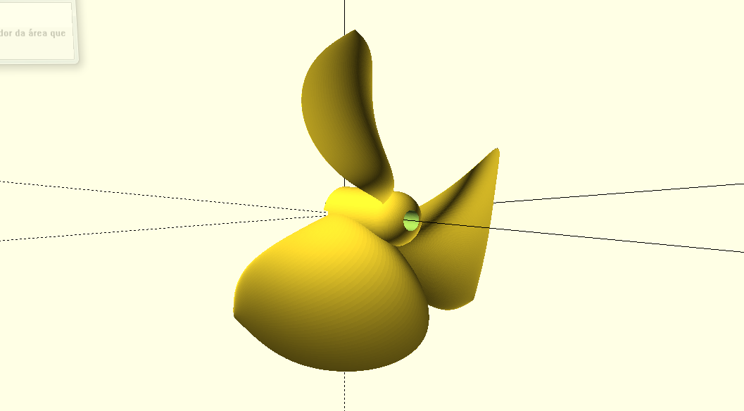

The following code seems fine using F5, but blows up as shown using F6.
When F6 completes, the propeller hub is visible, but the blades are
gone. Comments?

The following code seems fine using F5, but blows up as shown using F6. When F6 completes, the propeller hub is visible, but the blades are gone. Comments? === Compiling design (CSG Tree generation)... Rendering Polygon Mesh using CGAL... PolySet has nonplanar faces. Attempting alternate construction ERROR: Alternate construction failed. CGAL error in CGAL_Nef_polyhedron3(): CGAL ERROR: assertion violation! Expr: e->incident_sface() != SFace_const_handle() File: /opt/mxe/usr/x86_64-w64-mingw32.static/include/CGAL/Nef_S2/SM_const_decorator.h Line: 326 PolySet has nonplanar faces. Attempting alternate construction ERROR: Alternate construction failed. CGAL error in CGAL_Nef_polyhedron3(): CGAL ERROR: assertion violation! Expr: e->incident_sface() != SFace_const_handle() File: /opt/mxe/usr/x86_64-w64-mingw32.static/include/CGAL/Nef_S2/SM_const_decorator.h Line: 326 PolySet has nonplanar faces. Attempting alternate construction ERROR: Alternate construction failed. CGAL error in CGAL_Nef_polyhedron3(): CGAL ERROR: assertion violation! Expr: e->incident_sface() != SFace_const_handle() File: /opt/mxe/usr/x86_64-w64-mingw32.static/include/CGAL/Nef_S2/SM_const_decorator.h Line: 326 Geometries in cache: 39 Geometry cache size in bytes: 37537704 CGAL Polyhedrons in cache: 16 CGAL cache size in bytes: 101333344 Total rendering time: 0 hours, 1 minutes, 8 seconds Top level object is a 3D object: Simple: yes Vertices: 2840 Halfedges: 14042 Edges: 7021 Halffacets: 8364 Facets: 4182 Volumes: 2 Rendering finished. === use <naca4.scad> // see http://www.thingiverse.com/thing:898554 use <shortcuts.scad> // see http://www.thingiverse.com/thing:644830 use <naca_sweep.scad> // see http://www.thingiverse.com/thing:900137 use <splines.scad> // some parameters N = 100; // refinement R_axis = 100; // radius of axle r_bore = 37.5; // radius of axle bore size = .1; // sizing factor slices = false; // set true to view interpolation slices ty = 50; // common y-distancing of blades // core data to be interpolated by nSpline() // transform data airfoil nacaXYZZ //-------------------------------------------------- A = [ // Tx Ty Tz Rz Ry | L X ZZ [0, ty, 60, -25, 0, 300, .12, .1], [-50, ty, 200, -50, 0, 600, .2, .08], [-100, ty, 500, -75, 0, 450, .1, .06], [00, ty, 660, -82, 10, 10, .01, .1], ]; // Main object module MyProp() Rz(180) S(size, size, size) boat_prop(3); difference() { MyProp(); // drill out center hole rotate([0, 90, 0]) cylinder(h = 100, r = 3.75, $fn = 100); // dog slot cube([3.75, 20, 3.75], center = true); } module boat_prop(M = 2) { m = slices?1:M; // used for slices view $fn = N; // refinement shift = -130; // shift for axis parts shl = 270; // length of axis B = nSpline(A, 2*N); // interpolation D() // difference { U() // union of blades and axle { for(i=[0:360/m:359]) { C = gen_dat(slices?A:B,N); R(i) // = Rx(); x-rotates object sweep(C, showslices=slices); } if(!slices) axis(shift, shl); } Tx(shift+shl*.2) // translate Ry(90) // rotate Cy(r_bore,shl*.9); // cylinder } // generate all data - applies transformation and airfoil params function gen_dat(B,N) = [for(i=[0:len(B)-1]) let(R = B[i]) Tz_(R[2], // z-translate 2D-shape R_(R[4], 0, 180+R[3], // rotate 2D-shape T_(R[0],R[1], 0, // xyz-translate 2D-shape vec3D(airfoil_data(N=N, L=R[5], naca=[R[6],.5,R[7]], open=true) )))) ]; } module axis(shift = 0, shl = 200) { T(shift) // = Tx() Ry(90) Cy(R_axis,shl); T(-shl/2+shift) Ry(90) Sp(R_axis); // sphere }

jon,
The error you have goten is caused by non-planar faces in the sweep model.
Parkinbot has recently updated the Naca_sweep.scad in Thingiverse with a
version that triangulates all swept facets. You should download the more
recent version which works fine for me:

Jon,
I uploaded the newest version of Naca_sweep.scad to
http://www.thingiverse.com/thing:1208001. The sweep() in this version has
new parameters:
sweep(dat, convexity = 5, showslices = false, close = false, planar_caps =
false)
Using the default "planar_caps=false" triangulates the caps, as Ronaldo
already stated. Actually, I didn't have any problems to F6-render the code
with planar_caps set to true or false, using OpenSCAD 2017.01.20. Let me
anote that it might be a good idea to strengthen the blade at its root by
altering the last column ZZ in the matrix A. Try e.g.:

That did the trick!  Thank you!

So, now on to scaling.
We want a 1/2" shaft with a 3/16" center bore and a dog slot.  We also
want propellers that are roughly 3" in diameter.
I tried to express everything in native sizes by changing the "size"
value to 1, but that threw everything off, even after I tried to adjust
the values in the matrix by dividing them all by 10.  At the moment, the
shaft is correctly scaled, but the propellers do not touch the shaft,
and they are way too large.
I don't mean to be ungrateful for this amazing technology, but would it
be possible to allow some of these things to be adjusted in a way that
was less obscure and simpler?  If the answer is "I don't have time for
this", I completely understand.
Thanks for listening!

Jon,
if you see what you get within less than 100 lines, everything is as simple
as can be ;-)
I admit, the design uses of some magic library stuff concerning the blades.
But the rest, hub and bore is just OpenSCAD stuff using scale, difference
and union. You should be able to work this out on your own, also the mm/inch
rescale.
The matrix describes a single blade using a series of four slices being then
interpolated by nSpline():
[0,    ty,  60, -25,  0,  300,  .12,  .2], // root slice is
translated by [0, ty, 60], pitched by 25°
[-50,  ty,  200, -50,  0,  600,  .2,  .12], //
[-100, ty,  500, -75,  0,  450,  .1,  .06], //
[00,  ty,  660, -82,  10,  10,  .01,  .1], // tip slice
The first line describes the root, the last line the tip profile. The second
and third are intermediate profiles to "guide" the cubic spline
interpolation. You can introduce more lines, but they have to "fit into the
scheme", otherwise the interpolation scheme will freak out. As for the
columns the meaning is
Tx = translate slice along x
Ty = translate slice along y,
Tz = translate slice along z, (distance from axis)
Rz = rotate slice around z, (pitch)
Rz = rotate slice around y
used here
and
L = NACA cord length
X = NACA camber
Y = NACA location of max camber = 0.5 (not interpolated in this example)
ZZ = NACA factor thickness/cord
used here:
The first five parameters describe how the 2D-shape is positioned in 3D, the
last three columns describe the 2D shape itself. It is a 4 digit Naca
profile see https://en.wikipedia.org/wiki/NACA_airfoil.
The 4 digit naming scheme I used is: "nacaXYZZ", with X, Y, ZZ denoting
profile parameters. The matrix adresses the cord length L and only the X and
the ZZ parameters. The generator function calls into my naca4.scad library
to construct the 2D shape. It has a "constructor" airfoil_data() with an
overloaded "naca" parameter. One overload accepts NACA-Numbers like 1230,
and the other a vector like [.1, .2, .3]. Both result in the same profile,
NACA1230.
Hope this helps.

Very helpful, indeed!  Thank you!  I will keep this handy going forward!
I tried to make the props smaller by using a scale(0.5) on My Prop()
[see line 34].  The result is startling.  The hub vanishes.
