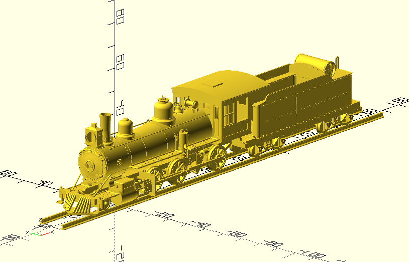

Well, I modeled this in plain 'ole OpenSCAD, with only the
RoundAnything/polyround.scad library and a path_extrude() routine I found
somewhere:
This was my first attempt at anything in OpenSCAD.  I'm a programmer, so I
was already familiar with working a language, found its quirks and just
worked around them.  The above is about 5000 lines of OpenSCAD.
For "geometric" models, I find OpenSCAD quite satisfactory, haven't run
into a locomotive part I can't make, yet.  Most helpful are loops, to do
regular patterns like rivet courses, and extrusions, both linear_ and
rotate_ .  modules are the backbone of organizing, once I made one driver
wheel, the others were just a 'translate(...) wheel();'

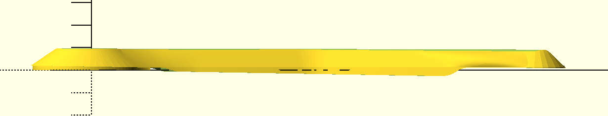

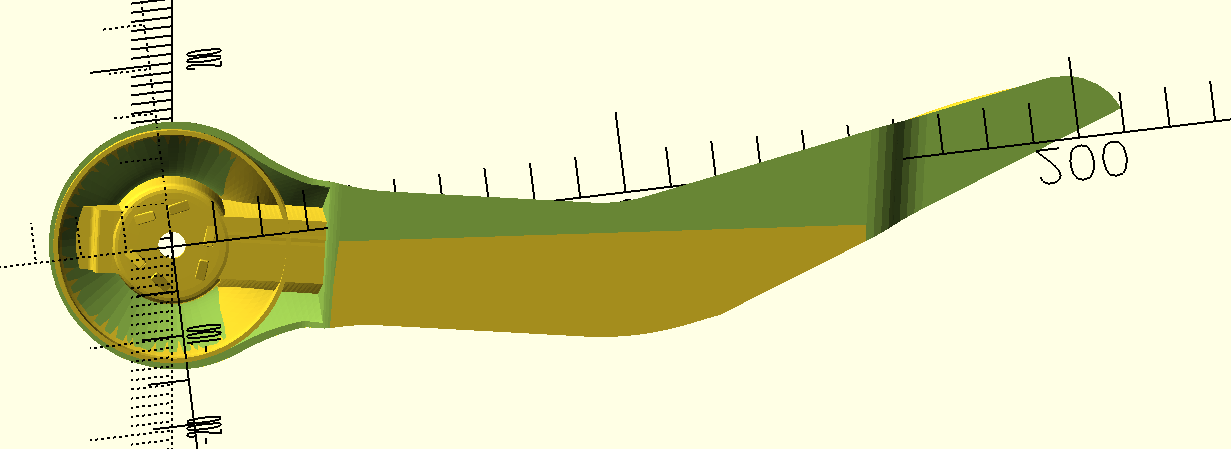

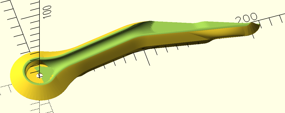

I had another attempt at this strange shape yesterday and this time it is
a slightly more respectable copy. It's amazing to see the power of python
[image: Screenshot 2026-06-20 at 10.10.45 PM.png]
[image: Screenshot 2026-06-20 at 10.11.30 PM.png]
[image: Screenshot 2026-06-20 at 10.12.04 PM.png]
If anyone wants to try
the scad file can be downloaded from :
https://github.com/sprabhakar2006/openSCAD/blob/main/strange_shape.scad
python code can be downloaded from:
https://github.com/sprabhakar2006/openSCAD/blob/main/strange_shape.txt
