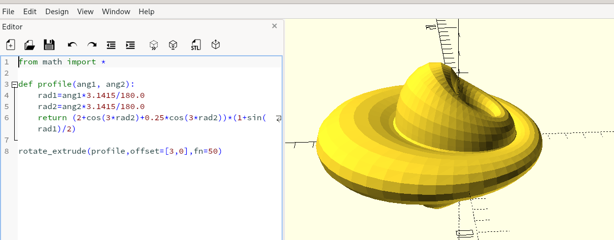

Extruding Python functions is a really cool thing!
https://imgpile.com/i/Gwmz6l
I am sure we could get many more nice effects using different frequencies
of Lissajous Figures ...

Hi John,
I am confident that this is possible with OpenSCAD only. I would guess this
is included in BOSL2, maybe Inphase's closepoints
function can exactly do that as well.
The advantage here is that the functionality is exactly there, where you
expect it(at rotate_extrude).(And you additionally have the option to add
more sophisticated things like more formulas, calculations, or e.g. getting
data from a file)
The callback thing is not yet final, trying to get it more general(like
using same for linear_extrude and path_extrude) and/or get the most
important set of parameters to rotate_extrude
but the main idea is there already i would say
Guenther

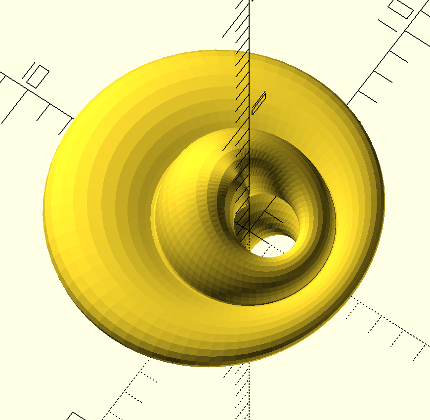

Mon, Nov 6, 2023 2:55 AM
Nevermind.  I figured it out.
liss_fn = function(ang1,ang2) (2+cos(3*ang2)+0.25*cos(3*ang2))*(1+sin(ang1)/2);
module rotate_sweep_by_func(fn,offset) {
    rows = [
        for (ang1=[0:5:360])
        let(
            profile = [
                for (ang2=[0:5:360])
                offset + polar_to_xy(liss_fn(ang1,ang2), ang2)
        zrot(ang1, p=xrot(90, p=path3d(profile)))
    vnf = vnf_vertex_array(rows);
    vnf_polyhedron(vnf, convexity=10);
rotate_sweep_by_func(liss_fn, offset=[3,0]);
  • Revar
