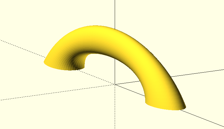

I'd like to make a handgrip for a project, but I don't have a clue how to
do organic shapes in OpenSCAD
Can someone point me in that direction please?

It might not be the perfect tool for this kind of model..
I suggest using wings3d
- staring with a cube
- using the extrude tool on faces
- and finally smoothing it for a good result. (you can smooth(S key twice)/undo as you go to see how your progressing)
This is a very good tool for that kind of object. Also the results are watertight and easily sliced for printing.
- http://www.wings3d.com/

Here are some ideas to model your handgrip in OpenSCAD. I use Bezier
surfaces to model the smooth surfaces of a handle and polyhedron as the
basic OpenSCAd primitive to build it.
The main code is simple and render in a snap.

The handle surface is determined by the position of the control points q0.
Change it to your taste. With show_CTP=true you will see the polygons
formed by the lines of control points and its relation with the surface.
