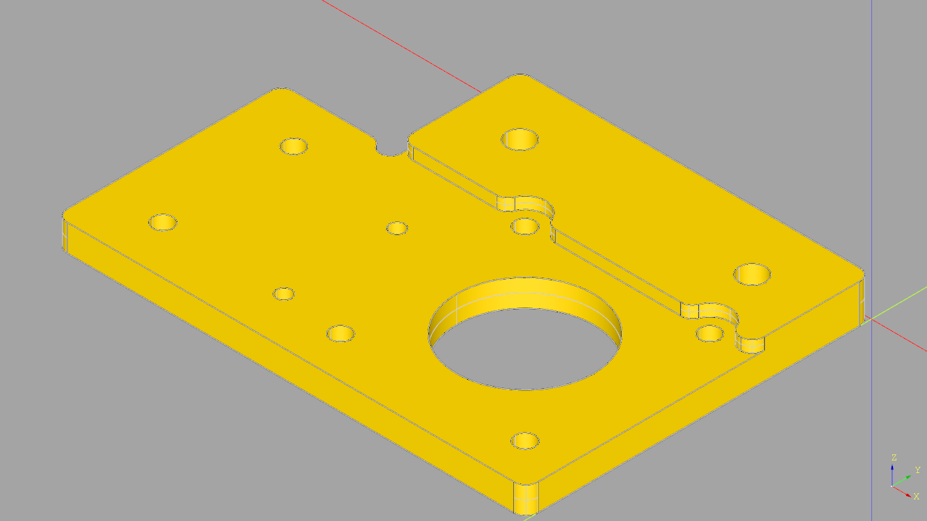

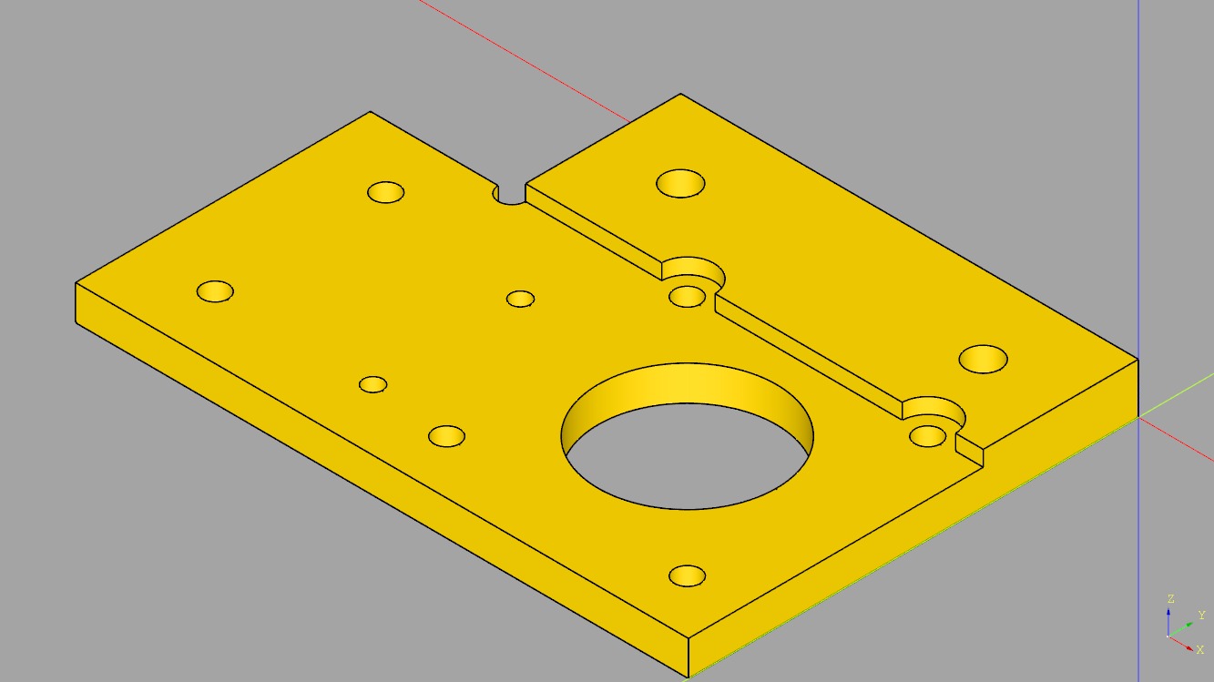

it seems that it is tricky to define an edge to be filleted in cq
Well, I haven't been using cq long, so I can't answer this in general. If
you want to define a single edge to be filleted this might be the case, but
if you want to fillet a lot of edges all at once, then cq makes this easy.
So for example result = result.edges("|Z").fillet(2) will fillet all
edges parallel to the Z axis, turning
[image: XY_MotorMountUnfilleted.png]
into
[image: XY_MotorMount.png]
in one simple step.
