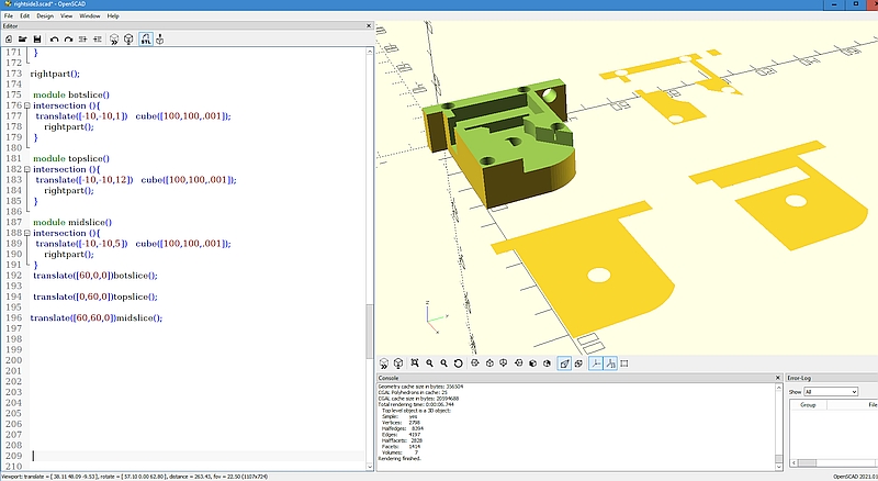

Well, whatever version of dxf, my cam program can import it OK and
generate the required G-codes. Now, since it is mostly 2,5D (simple
pocketing/profiling on 3 axis mill) I basically need outlines and depths
of cut, the illustration shows a simple part. Using intersections on a
large cube, I can get the profiles, but is there a simple way to get
them into 2d, and perhaps combine them as one dxf export?

if you drop the Z parameter on the translates, and change Cube to Square it
will be 2D, im not sure how that works for you since you need depth of
cut...  also when you render it, its distinctly different looking..  like
the attached picture...
http://forum.openscad.org/file/t3134/Screen_Shot_2021-02-17_at_10.png
if you drop the Z parameter on the translates, and change Cube to Square it will be 2D, im not sure how that works for you since you need depth of cut... also when you render it, its distinctly different looking.. like the attached picture... <http://forum.openscad.org/file/t3134/Screen_Shot_2021-02-17_at_10.png> -- Sent from: http://forum.openscad.org/
Wed, Feb 17, 2021 4:38 PM
Use projection() to convert 3D to 2D.

Thanks for your help. I can get the similar change of colour on
rendering, and a dxf file, if I draw in 2d. However, in the 3d example I
quoted, I can 'slice it' by using squares, by translating the 3d object
down, instead of increasing the square height, so to speak, However, if
I render it, it ignores the 2d parts. If I remove the 3d part (comment
out it's display line) then it will not render.
I've a simpler part below, that I can't get to export. How do I get a
dxf file for the two 'discs' ?
module test(){
    cylinder(50,20,10);
test();
module bot(){
    intersection(){
         square(100,true);
        translate([0,0,-1])test();
translate([50,50,0])bot();
module upper(){
    intersection(){
        square(100,true);
        translate([0,0,-40])test();
translate([0,50,0])upper();
//Best wishes,
//Ray
