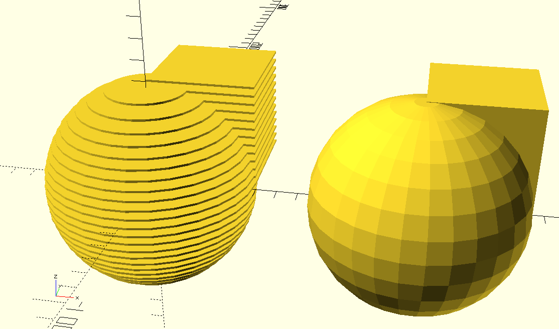

Is this what you need?
r=50;
dr=4;
module my_object(){
sphere(r);
cube(r);
module slice(dr=dr){
for(i=[-r:dr:r]){
translate([0,0,i])linear_extrude(1)translate([0,0,i*r])projection(cut=true)translate([0,0,-i])children();
slice()my_object();
translate([2.5*r,0,0])my_object();

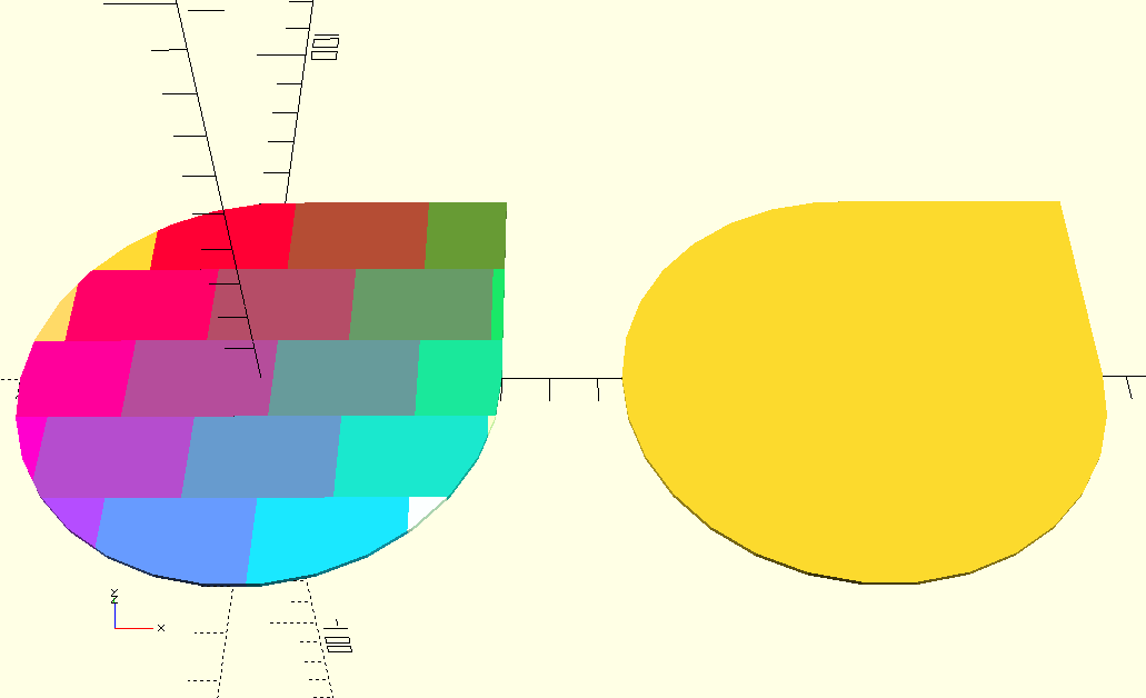

So here is one slice (z=0) tiled:
​r=50;
dr=4;
xmax=30;
ymax=20;
module my_object(){
sphere(r);
cube(r);
for(i=[-r:dr:r]){
//slice()my_object();
//translate([2.5*r,0,0])my_object();
module tile(i=0){
for(iy=[-r:ymax:r]){
for(ix=[-r-xmax:xmax:r+xmax]){
color([.5-(ix)/r/2,1-(.5-(ix)/r/2),.5-(iy)/r/2])
render()intersection(){
translate([0,0,ir])projection(cut=true)translate([0,0,-i])children();
translate([ix+xmax/2
iy/ymax,iy])square([xmax,ymax]);
tile()my_object();
translate([2.5*r,0,0])projection(cut=true)my_object();

Wed, May 18, 2016 8:35 PM
Almost there. The tiles of one slice should be offset relative to the
adjacent ones.

Almost there. The tiles of one slice should be offset relative to the adjacent ones. 2016-05-18 16:44 GMT-03:00 Peter Falke <stempeldergeschichte@googlemail.com> : > So here is one slice (z=0) tiled: > > > ​r=50; > dr=4; > xmax=30; > ymax=20; > > > module my_object(){ > sphere(r); > cube(r); > } > > > module slice(dr=dr){ > for(i=[-r:dr:r]){ > > translate([0,0,i])linear_extrude(1)translate([0,0,i*r])projection(cut=true)translate([0,0,-i])children(); > } > } > > > //slice()my_object(); > > //translate([2.5*r,0,0])my_object(); > > > module tile(i=0){ > for(iy=[-r:ymax:r]){ > for(ix=[-r-xmax:xmax:r+xmax]){ > color([.5-(ix)/r/2,1-(.5-(ix)/r/2),.5-(iy)/r/2]) > render()intersection(){ > > translate([0,0,i*r])projection(cut=true)translate([0,0,-i])children(); > translate([ix+xmax/2*iy/ymax,iy])square([xmax,ymax]); > } > } > } > } > > > tile()my_object(); > translate([2.5*r,0,0])projection(cut=true)my_object(); > > 2016-05-18 1:53 GMT+02:00 Tony Godshall <togo@of.net>: > >> Also you can render OpenSCAD to STL and slice with Slic3r, which is >> free/open source. >> >> http://slic3r.org/ >> >> It can render to G-code or SVG. >> >> >> On Tue, May 17, 2016 at 4:02 PM, Parkinbot <rudolf@parkinbot.com> wrote: >> > Jago, >> > >> > slicing a 3D object into any pattern of pieces with free (or fixed) >> sizing >> > is a task OpenScad is equipped for. What about the data format and >> object >> > size you deliver and which formats can your laser cutter consume? >> OpenScad >> > can read STL and write DXF and SVG for this purpose. >> > If that is what you are seeking, a batch file with parametrized OpenScad >> > commandline calls generating a series of pieces with naming scheme >> would be >> > the preferable solution. So, what is your platform (Windows, Linux, >> MacOS)? >> > >> > Rudolf >> > >> > >> > >> > >> > -- >> > View this message in context: >> http://forum.openscad.org/Slice-object-into-overlapping-slices-for-laser-cutter-like-123D-Make-but-better-tp17332p17340.html >> > Sent from the OpenSCAD mailing list archive at Nabble.com. >> > >> > _______________________________________________ >> > OpenSCAD mailing list >> > Discuss@lists.openscad.org >> > http://lists.openscad.org/mailman/listinfo/discuss_lists.openscad.org >> >> >> >> -- >> -- >> Best Regards. >> This is unedited. >> This message came out of me >> via a suboptimal keyboard. >> >> _______________________________________________ >> OpenSCAD mailing list >> Discuss@lists.openscad.org >> http://lists.openscad.org/mailman/listinfo/discuss_lists.openscad.org >> > > > _______________________________________________ > OpenSCAD mailing list > Discuss@lists.openscad.org > http://lists.openscad.org/mailman/listinfo/discuss_lists.openscad.org > >
R
Ronaldo
Wed, May 18, 2016 9:25 PM
r=50;
dr=4;
xmax=30;
ymax=20;
sp = 1; // spacing between tiles in spreading
module my_object(){
sphere(r);
cube(r);
for(i=[-r:dr:r]){
module tile(i=0,dx=0,dy=0){
for(iy=[-r-dyymax:ymax:r+dyymax]){
for(ix=[-r-xmax-dxxmax:xmax:r+xmax+dxxmax]){
translate([spix/xmax,spiy/ymax,0])
translate([ix+xmax/2*iy/ymax-(i%2)xmax3/4,iy-(i%2)*ymax/2])square([xmax,ymax]);
// three adjacent layers
tile(0)my_object();
translate([0,0,5]) tile(1) my_object();
translate([0,0,10]) tile(2) my_object();
The parameters dx and dy (between 0 and 1) of tile() allow for small tilling
displacement to avoid too small tilling pieces in a layer by layer basis.
View this message in context: http://forum.openscad.org/Slice-object-into-overlapping-slices-for-laser-cutter-like-123D-Make-but-better-tp17332p17345.html
That is what I meant: <http://forum.openscad.org/file/n17345/OffsetTilling.png> > r=50; > dr=4; > xmax=30; > ymax=20; > sp = 1; // spacing between tiles in spreading > > > module my_object(){ > sphere(r); > cube(r); > } > > > module slice(dr=dr){ > for(i=[-r:dr:r]){ > > translate([0,0,i])linear_extrude(1)translate([0,0,i*r])projection(cut=true)translate([0,0,-i])children(); > } > } > > > //slice()my_object(); > > //translate([2.5*r,0,0])my_object(); > > > module tile(i=0,dx=0,dy=0){ > for(iy=[-r-dy*ymax:ymax:r+dy*ymax]){ > for(ix=[-r-xmax-dx*xmax:xmax:r+xmax+dx*xmax]){ > translate([sp*ix/xmax,sp*iy/ymax,0]) > render()intersection(){ > > translate([0,0,i*r])projection(cut=true)translate([0,0,-i])children(); > > translate([ix+xmax/2*iy/ymax-(i%2)*xmax*3/4,iy-(i%2)*ymax/2])square([xmax,ymax]); > } > } > } > } > > // three adjacent layers > tile(0)my_object(); > translate([0,0,5]) tile(1) my_object(); > translate([0,0,10]) tile(2) my_object(); > translate([2.5*r,0,0])projection(cut=true)my_object(); The parameters dx and dy (between 0 and 1) of tile() allow for small tilling displacement to avoid too small tilling pieces in a layer by layer basis. -- View this message in context: http://forum.openscad.org/Slice-object-into-overlapping-slices-for-laser-cutter-like-123D-Make-but-better-tp17332p17345.html Sent from the OpenSCAD mailing list archive at Nabble.com.
