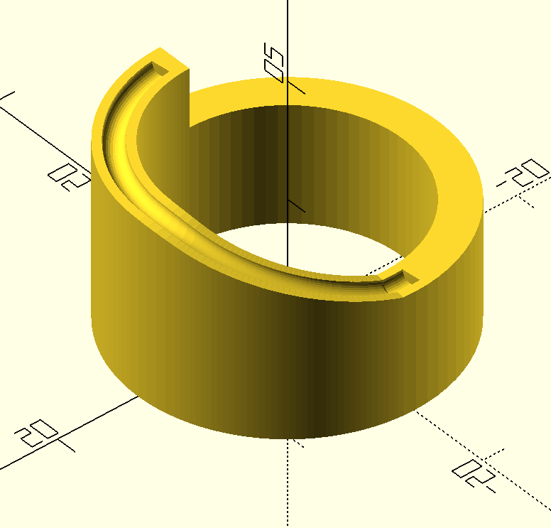

Idea is in this code:
include<dependencies.scad>
sec=m_points_so(cr(pts1([[0,10],[0,5],[12,0,5],[10,-5],[23,0]]),5),20,.1);
max_x=max(sec*[1,0]);
p_line(sec,.1);
echo(max_x);
sec1=[for(i=[0:len(sec)-1])[13cos(sec[i].x/max_x360),13sin(sec[i].x/max_x360),sec[i].y]];
sec2=[for(i=[0:len(sec)-1])[10cos(sec[i].x/max_x360),10sin(sec[i].x/max_x360),sec[i].y]];
sec3=cpo([sec1,sec2]);
surf_base(sec3);

I'm trying to simulate this knob. I can handle everything but the circular
side with a channel on it.
I can do the flat circular side with the channel, but I cannot figure out
how to do the halt side that has an inclination.
the code I have for the side part it is:
$fn = 360;
outsideChannelFlat();
//channelProfile();
module outsideChannelFlat(){
rotate_extrude(angle = 180, convexity = 2) {
translate([57.5/2,0,0])
channelProfile();
module channelProfile(){
square([7.2,16.5],center = false);
translate([7.2/2,16.5,0])
circle($fn = 180,  r = 4.5/2);
Any help with the inclined part it is welcomed.
Thank you,
Sorin

code is here:
sec=m_points_so(cr(pts1([[0,10],[0,5],[12,0,5],[10,-5],[23,0]]),5),40,.1);
//p_line(sec,.1);
echo(max_x);
sec4=loop(sec,44,131);
//p_lineo(sec4);
path=[for(i=[0:len(sec4)-1])[11.5cos(sec4[i].x/max_x360),11.5sin(sec4[i].x/max_x360),sec4[i].y]];
sec5=cir(.8,s=30);
prism=[for(i=[0:len(path)-2])let(
i_plus=i+1,
p0=path[i],
p1=path[i_plus],
v1=p1-p0,
v2=[p0.x,p0.y],
a1=ang(norm([v1.x,v1.y]),v1.z),
a2=ang(v2.x,v2.y)+90,
ang1=is_num(a1)?a1:0,
ang2=is_num(a2)?a2:0,
sec=q_rot(["x90","z-90"],sec5),
a_sec=trns(p0,q_rot([str("y",ang1),str("z",ang2)],sec))
)a_sec];
render()
surf_base(sec3);
swp(prism);}

replace last difference command with following to avoid rendering issues:
surf_base(flip(sec3));
swp(flip(prism));}
