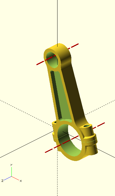

The default green changes to default gold with linear_extrude. That looks a bit naff when other differenced surfaces remain green. Try activating and cancelling linear_extrude (second line from last) in the example below.
$fn=100;
l=35;
$vpr=([ -30, 45, 0 ]); // Isometric$vpt=([ 0, -l/2+3, 0 ]); $vpd=200;
module conrod(diff)
offset(-5)
offset(5)
circle(5-diff);
translate([0,-l,0])
circle(9-diff);
hull()
circle(5-1.0-diff);
translate([0,-l,0])
circle(9-3-diff);
circle(5-1.5+diff);
translate([0,-l,0])
circle(9-2+diff);
//linear_extrude(6, center=true)
conrod(diff=0);
Is there a solution other than subtracting a minimally enlarged object where the green disappears?

What is happening is that without the linear_extrude it's a 2D object,
which is simulated in the previewer as a one-unit-thick 3D object, and
the green on the cut-away parts takes effect.  With the linear_extrude,
the 2D shape is fully resolved into all-new polygons and all traces of
how it was created are lost; the linear_extrude generates an entirely
new polyhedron.
You could do the difference in 3D instead of 2D, and the green would
remain, but that's a lot slower.
OpenSCAD has only very limited abilities to color different faces of an
object differently.
