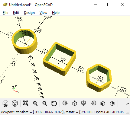

Hello!
in case anyone has some time to spare..... i made for the study of my wife
these handles:
https://github.com/nohkumado/covid19_doorhandle
(https://www.thingiverse.com/thing:4233677 for some pictures)
i remove from a cylinder the shape of my doorknob, done with a
rotate_extrude circle, i am maybe getting tired of looking at the thing :D
but i don't get it why there's stuff hanging in the air on both ends of the
clamp? the thing i used for difference is longer than the cylinder i am
excavacating, this should do the job?
and another question:
is there a way to pass the knob module a shape to extrude?
if someone wants to make that handle with some other strange shape, he will
have to dig into the module.... passing the shape as argument to the
module, is that somehow possible?
thanks in advance!
ciao
Bruno

No, the thing you're subtracting out isn't longer than the thing you're
extracting it from.
For your knob() module, when knobrad is non-zero (as it is here), you
drop into the curved-part handling at 52-57, and there the "length" is
based on "alpha", not based on "len".  The two use the same "alpha" and
so you end up with the issues you see here.
will have to dig into the module.... passing the shape as argument to
the module, is that somehow possible?
Yes, though it might be a little tricky - especially when you want it to
fix into the rest of the device.
Did you mean to pass a 2D shape to knob(), or a 3D shape to doorknob()?
The concepts are the same.
You use the children() feature.
For instance, you might want something sort of like this:
module handle(len) {
        linear_extrude(height=len) {
            offset(r=2) children();
        translate([0,0,-1]) linear_extrude(height=len+2) {
handle(10) {
    circle(d=20);
translate([40,0,0]) handle(10) {
    square(20, center=true);
translate([80,0,0]) handle(10) {
    circle(d=20, $fn=6);
yields:

I have gotten a clean shape by  changing the code line:
knob(knobdia+luft, knoblen+2,knobrad);
to
knob(knobdia+luft, knoblen+2,knobrad+2);
in the doorknob() module.

Yes, as a children()

awesome thanks ,to both, too much looking sometime impaires the brain :D
i will try with the children, and Jordan yes for starters i have one door
where the knob has a form like a sort of F shape....
lets see if i manage that one
but for the moment the printer is busy printing the handles for the main
doors....
if ever someone wants to make look this thing better (smoother), feel free
:) its on github....
