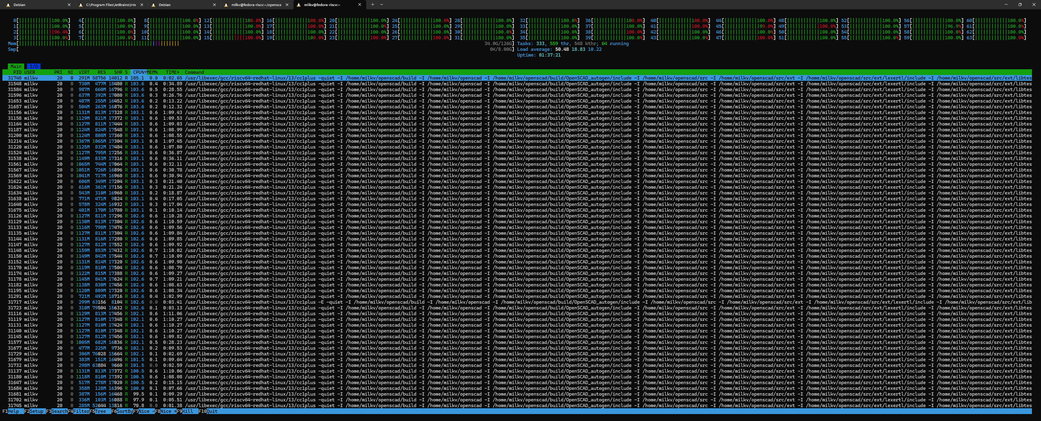

Hello there,
I got a RISC-V machine recently, and I'm trying to get the software I use
working on it.
I tried to compile OpenSCAD on it, and it worked, despite being on Fedora
38.
How hard would it be to supply the next release for this architecture?
Thanks.

For example, I installed OpenSCAD on my aarch64 Chromebook running a Debian
variant, using the package manager, which worked well.
Additionally, I built and published a riscv64 Docker image with the master
branch of OpenSCAD (
https://hub.docker.com/repository/docker/gounthar/openscad/tags), which was
built on GitHub using a Docker build action (
https://github.com/MerryKombo/3DDesign/blob/fosdem-2025/.github/workflows/build-and-push-docker-image.yml
I believe I could also build binaries for all supported architectures in a
GitHub Action using Docker.
If you'd like, I can propose a PR that would implement this approach. Just
let me know!
