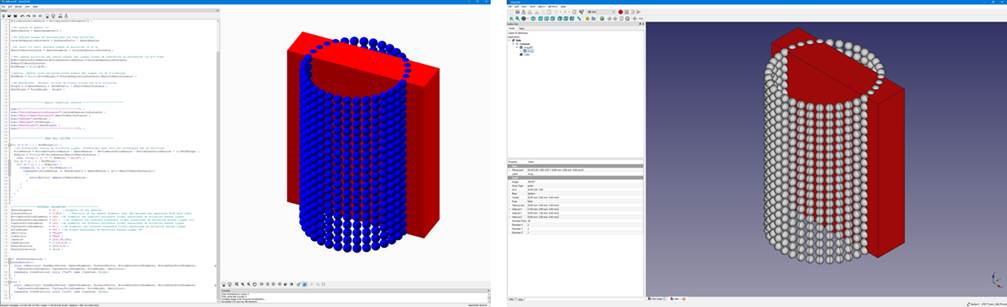

Hi All,
I’m running some benchmark tests to predict the amount of time I need for the final design and ran into some performance problems.
I calculate the intersection of a cuboid and a circular stack of 680 spheres. I included the script. Please don’t comment the messy setup or the purpose of the script. This is for benchmarking purposes only 😉. See below for the union and intersect within the GUI, as well as a view of the rendered STL in MeshLab.
While the GUI (F5) masters the intersection in less than 1 second, rendering it for STL export (F6) takes 44 minutes (on a Core i9 9900 3.1Ghz with 32GB RAM on an Asus ROG STRIX 8360F motherboard). Also, the memory consumption of OpenSCAD grows from 250 MB to more than 8 GB at the end of the rendering process.
Below is a screenshot of Sysinternals, showing that OpenSCAD uses up to 8 GB memory and 6.4% CPU for this script (the latter indicating that the script runs single threaded).
Why does the rendering process take so long and why does it take so much memory?
Pete.

Hi Ron,
Results are here.
With $fn=-5, calculation duration decreases from 44 to 22 minutes. I don’t know why.
I cannot find any documentation about negative $fn values though, except that its minimum value is 0.01.
By the way, I am benchmarking OpenSCAD/CGAL against FreeCAD/Opencascade here.
FreeCAD/OpenCascade does this job in less than a second and I don’t see fundamental differences in the STL files that are produced, except some minor differences in the placement of facets, and the fact that FreeCAD produces a binary STL instead of ASCII.
So there is still a difference in performance of a factor of 1000 in this case which is worth considering for me.
Below a screenshot of both designs in OpenSCAD and FreeCAD.
Pete.

Michael Marx
Thu, Aug 13, 2020 11:36 PM
I believe that was a dash not minus.
https://en.wikibooks.org/wiki/OpenSCAD_User_Manual/Other_Language_Features#$fa,$fs_and$fn
If $fn <=0 then the $fa/$fs calculation is used.

Michael Marx
Thu, Aug 13, 2020 11:59 PM
3
See the link in previous email.
yep.
Multi-threaded Geometry https://github.com/openscad/openscad/issues/391  rendering [$1,060] #391

Results are here.
With $fn=-5, calculation duration decreases from 44 to 22 minutes. I don't know why.
0.01.
FreeCAD/OpenCascade does this job in less than a second and I don't see fundamental differences in
considering for me.
Pete.
