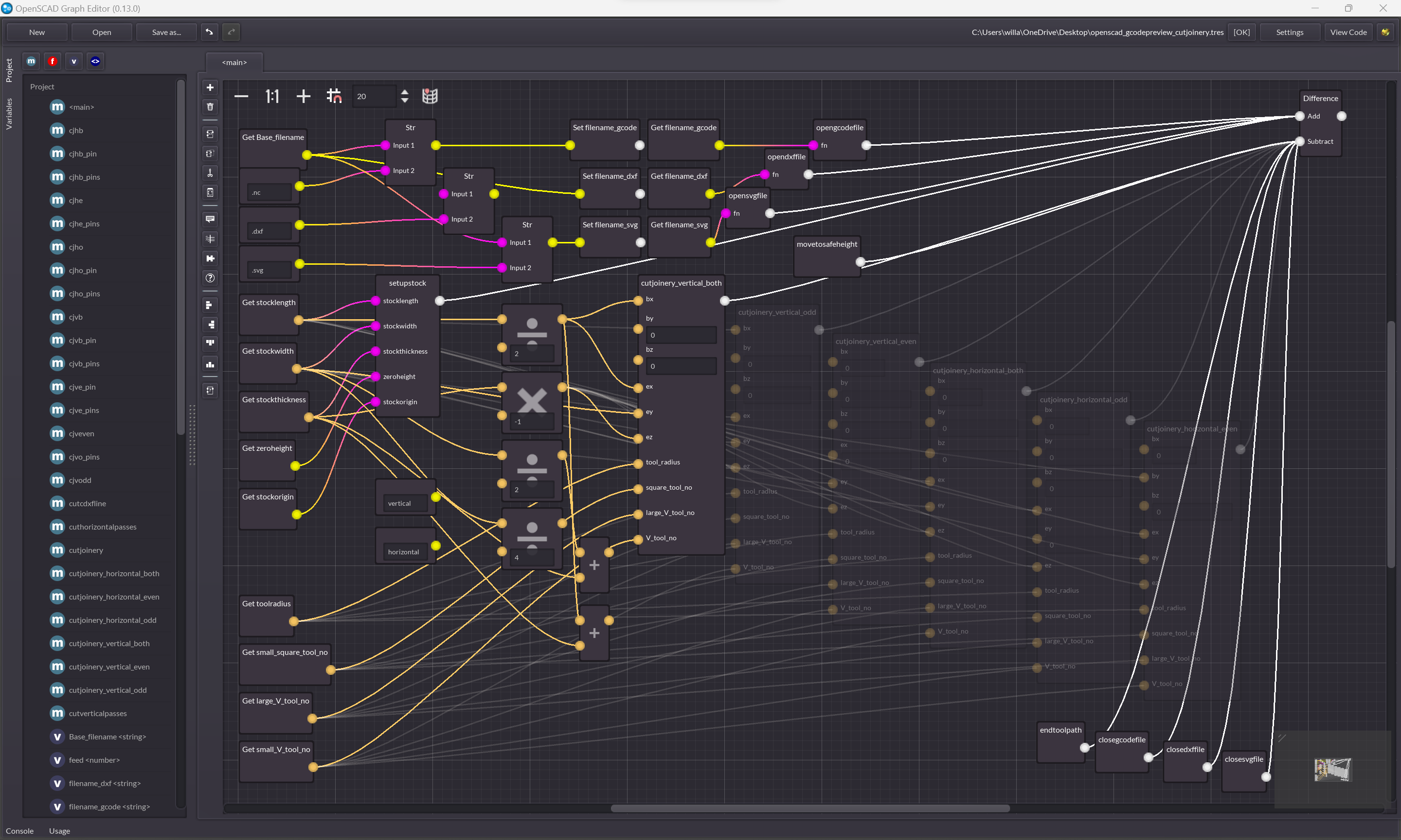

Actually, I do both --- I use (Open)PythonSCAD as a core, then wrap it up in OpenSCAD code so as to make the functionality I have coded up available, then I load that into OpenSCAD Graph Editor:
https://github.com/derkork/openscad-graph-editor
and use it as shown in the attached image.

Interesting... Can you give some use case examples why the node graphic
editor was written?  I've used similar looking glyph-based programming
interfaces to great success in the distant past, but that fitted very
specific niches.

Interesting... Can you give some use case examples why the node graphic editor was written?
I've used similar looking glyph-based programming interfaces to great success in the distant past,
but that fitted very specific niches.
My understanding is the developer of:
chose to write it so as to be able to use it.
I like it as a graphical expression since I have dreamed of this sort of thing since reading Herman Hesse's The Glass Bead Game (originally published as Magister Ludi) when I was a teen.
I am hoping to work up some new examples once I finish the current feature I am working on in my project, a joinery module for full-blind box joints at 90 degree angles and in both horizontal and vertical orientations.

I agree with John.  I can understand the utility of the graphical
network for small projects or for people learning the principles of
OpenSCAD, but I have yet to see a complex project where this approach
was important and helpful.  Any examples come to mind?

For me, the utility is in the graphical representation and the ability to arrange in two dimensions/orientations as opposed to the single axis of a text file (positioning a line or block above or below). It also helps that syntax is enforced, so no errors on my part on that count.
The problem of course is that it is best suited to problems which may be described one screenful at a time, and more complex problems can rapidly devolve into spaghetti:
https://blueprintsfromhell.tumblr.com/
https://scriptsofanotherdimension.tumblr.com/
The unanswered question of course is, "What does an algorithm look like?" and the corollary is it possible to have a meaningful and expressive graphical representation.
I still frequently rough out designs or initial algorithms using:
https://www.blockscad3d.com/editor/
(and sometimes OpenSCAD Graph Editor)
and then transfer that code into OpenSCAD (or Python), so it it is helpful to me.
