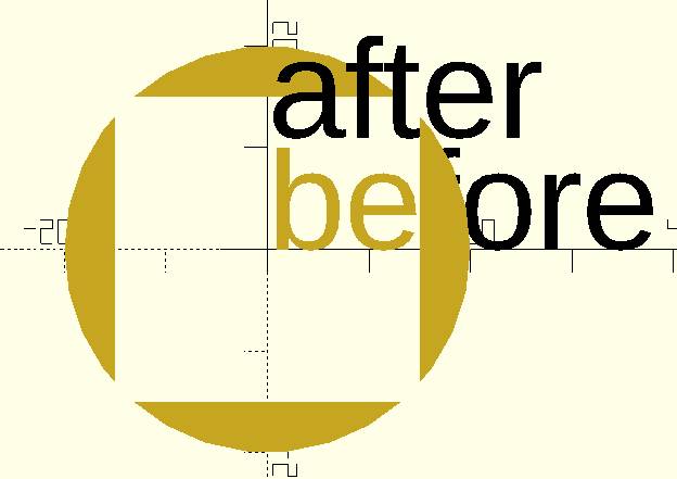

Interesting issue with color() function on Mac OS since late december nightly
builds. M1 Macbook Air (Big Sur, of course, seeing as it's an M1, V.11.2)
If I place coloured text overlays at the beginning of a document (where I
always have in the past), the colour gets overidden by the later components
of the drawing where the two intersect. This wasn't a problem with 2019.05
and back. My first appearance was 2020.12 and screenshots from 2021.1.2
Placing the coloured text at the end of the document solves the problem, so
I'm guessing this is down to some streamlining of the code? I'm not overly
bothered by it, as it's fixed by an easy change of operation convention, but
thought it best to point it out, in case it's down to something overlooked
and serious.
Screeners attached

Can you post the script or a simplified version of it which reproduces the
issue?
It looks like the issue has to do with your 2d text sharing the same face
as other 2D objects (even if those are negative, difference'd objects)
which is simply one of the limitations of how OpenCSG renders aka
Z-fighting.
But this was also the case for the 2019.05 release, so I don't believe the
same script would have worked there either.
Another way to fix it would be to give your 2D objects real thickness with
linear_extrude, and then translate the text along positive Z to actually be
above the other geometry.

You can Z-translate 2D.
translate([0,0,1])
color("black")
text("before");
circle(r=20);
square(30,true);
translate([0,11])
color("black")
text("after");
It even renders.

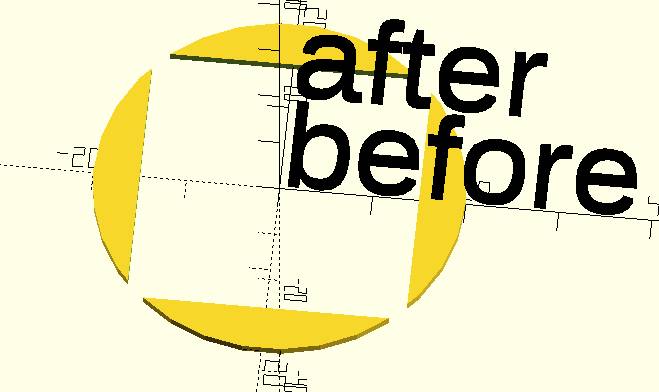

Steve,
This is not a bug.
The visual result of Z-fighting* is indeterminate and will depend on many things.
translate([0,0])
color("black")
text("before");
circle(r=20);
square(30,true);
translate([0,11])
color("black")
text("after");
When looked at via view/top, looks conclusively like a bug.
Viewed differently;
Shows Z-fighting even in the 'after' text.
Try my suggestion
translate([0,0,1])
color("black")
text("before");
circle(r=20);
square(30,true);
translate([0,11,1])
color("black")
text("after");

Steve, This is not a bug. The visual result of Z-fighting* is indeterminate and will depend on many things. * https://en.wikipedia.org/wiki/Z-fighting translate([0,0]) color("black") text("before"); difference() { circle(r=20); square(30,true); } translate([0,11]) color("black") text("after"); When looked at via view/top, looks conclusively like a bug. Viewed differently; Shows Z-fighting even in the 'after' text. Try my suggestion translate([0,0,1]) color("black") text("before"); difference() { circle(r=20); square(30,true); } translate([0,11,1]) color("black") text("after"); > -----Original Message----- > From: Discuss [mailto:discuss-bounces@lists.openscad.org] On Behalf Of crunchysteve > Sent: Mon, 4 Jan 2021 00:35 > To: discuss@lists.openscad.org > Subject: Re: [OpenSCAD] color() thing > > The script is visible in the screenshots but it's this for the text colour > being overridden... > osRad = 38; > > color("black"){ > translate([-200,200]) text(text="Chambered Headless Bass Body"); > translate([0,80]) text(text="Upper Chamber"); > translate([-10,115]) text(text="Upper Sound Hole"); > translate([70,0]) text(text="Solid spine for Set Neck"); > translate([0,-85]) text(text="Lower Chamber"); > translate([235,-102]) text(text="Lower Sound Hole"); > translate([-20,-130]) text(text="Control Panel"); > } > > //mirror([0,1,0]){ > difference(){ > shape(); > difference(){ > offset(r=-4.5) shape(); > translate([-120,0]) square([63,190]); > } > } > > difference(){ > offset(r=-25) shape(); > offset(r=-26) shape(); > } > > difference(){ > offset(r=-52) shape(); > offset(r=-53) shape(); > } > > difference(){ > offset(r=-80) shape(); > offset(r=-81) shape(); > } > > difference(){ > offset(r=-110) shape(); > offset(r=-111) shape(); > } > > difference(){ > translate([238,-98]) circle(28); > translate([238,-98]) circle(26); > } > translate([-90,-60]) square([363,1]); > translate([-90,59]) square([425,1]); > translate([-1,-70]) square([1,140]); > > translate([-15,-15]) scale(1.2) difference(){ > boltHole(); > offset(r=-2) boltHole(); > } > //} > > module shape(){ > offset(r=osRad) offset(r=-osRad) offset(r=-osRad) offset(r=osRad){ > difference(){ > circle(190); > translate([-195,-195]) square([195,390]); > } > difference(){ > scale([0.6,1]) circle(190); > translate([-120,-80]) square([60,160]); > } > difference(){ > translate([255,0]) scale([0.6,1]) circle(147); > translate([255,-150]) square([280,150]); > } > translate([255,-114]) circle(31); > translate([255,-112]) square([35,5]); > translate([255,-33]) square([88,33]); > } > offset(r=osRad/10) offset(r=-osRad/10){ > translate([255,-33]) square([88,33]); > } > } > > module boltHole(){ > polygon([[-20,140],[50,130],[55,120],[120,100],[45,110],[40,120]]); > } > > ...and this for it not... > osRad = 38; > > //mirror([0,1,0]){ > difference(){ > shape(); > difference(){ > offset(r=-4.5) shape(); > translate([-120,0]) square([63,190]); > } > } > > difference(){ > offset(r=-25) shape(); > offset(r=-26) shape(); > } > > difference(){ > offset(r=-52) shape(); > offset(r=-53) shape(); > } > > difference(){ > offset(r=-80) shape(); > offset(r=-81) shape(); > } > > difference(){ > offset(r=-110) shape(); > offset(r=-111) shape(); > } > > difference(){ > translate([238,-98]) circle(28); > translate([238,-98]) circle(26); > } > translate([-90,-60]) square([363,1]); > translate([-90,59]) square([425,1]); > translate([-1,-70]) square([1,140]); > > translate([-15,-15]) scale(1.2) difference(){ > boltHole(); > offset(r=-2) boltHole(); > } > //} > > module shape(){ > offset(r=osRad) offset(r=-osRad) offset(r=-osRad) offset(r=osRad){ > difference(){ > circle(190); > translate([-195,-195]) square([195,390]); > } > difference(){ > scale([0.6,1]) circle(190); > translate([-120,-80]) square([60,160]); > } > difference(){ > translate([255,0]) scale([0.6,1]) circle(147); > translate([255,-150]) square([280,150]); > } > translate([255,-114]) circle(31); > translate([255,-112]) square([35,5]); > translate([255,-33]) square([88,33]); > } > offset(r=osRad/10) offset(r=-osRad/10){ > translate([255,-33]) square([88,33]); > } > } > > module boltHole(){ > polygon([[-20,140],[50,130],[55,120],[120,100],[45,110],[40,120]]); > } > > color("black"){ > translate([-200,200]) text(text="Chambered Headless Bass Body"); > translate([0,80]) text(text="Upper Chamber"); > translate([-10,115]) text(text="Upper Sound Hole"); > translate([70,0]) text(text="Solid spine for Set Neck"); > translate([0,-85]) text(text="Lower Chamber"); > translate([235,-102]) text(text="Lower Sound Hole"); > translate([-20,-130]) text(text="Control Panel"); > } > > > > ----- > Make things, travel and tell stories. > -- > Sent from: http://forum.openscad.org/ > > _______________________________________________ > OpenSCAD mailing list > Discuss@lists.openscad.org > http://lists.openscad.org/mailman/listinfo/discuss_lists.openscad.org -- This email has been checked for viruses by AVG. https://www.avg.com
