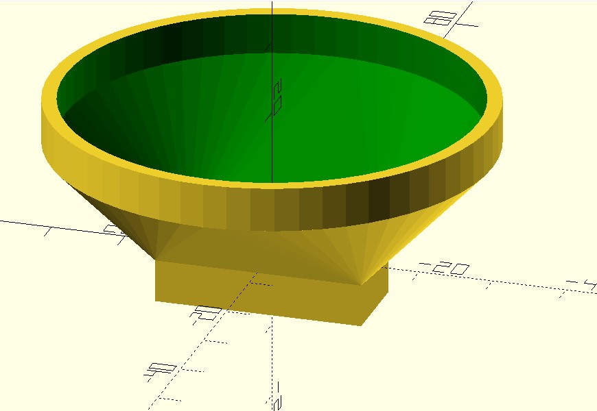

Thanks for all the help.  Here's the code I came up with to do this job.
Hope it helps someone else.
/*07/12/21 Pill dispenser adaptor for pill bottles
with various size caps. The cap fits into the top,
and the center of the cap is cut away to allow the
pills to fall down into the funnel.
This part gets mated with the actual dispenser
mechanism in TinkerCad
rect_w = 12; //rectangle width
rect_l = 28; //rectangle height
th = 2; //wall thickness of the completed object
cyl_id = 56; //id to match pillbottle lid
cyl_od = cyl_id + 2*th; //outside diameter
ht = 16; //total height of morphed element
rect_h = 6; //height of just the rectangular solid
rim_ht = 6; //height of the collar above the morphed element
fn = 60; //number of sides making up cylinders
module cube_cyl(w,l,rect_h,dia, ht)
dh = 0.5;
echo(w = w, l = l, h = ht);
echo(rect_l = rect_l, rect_w = rect_w, rect_h = rect_h);
hull()
cube([w,l, dh], center=true);
translate ([0,0,ht]) cylinder (d=dia, h=0.5, $fn=fn);
translate ([0,0,-rect_h/2])cube([w,l,rect_h], center=true);
translate ([0,0,ht+rim_ht/2])cylinder(h=rim_ht, d=dia, center=true,
$fn=fn);
difference ()
cube_cyl(rect_w,rect_l, rect_h, cyl_od,ht);
color("green")
translate ([0,0,-0.5])cube_cyl(rect_w-th,rect_l-th,rect_h+th, cyl_id,ht+1);
