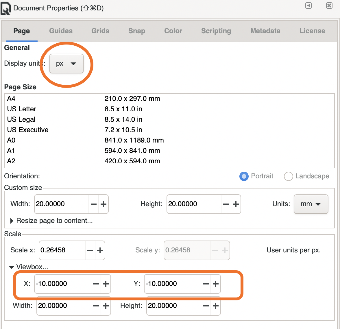

Hi nop.head,
first question:
I don't have an answer but importing the SVG into Inkscape and
looking for  "Document Properties.." looks like this (what is strange):
[image: Bildschirmfoto 2020-06-18 um 17.01.16.png]
In the Scale/Viewbox section is set X and Y = -10 what should be both =0
That is the reason for the offset. I think that's a bug in OpenSCAD export.
And a minor thing: I have the Display Units always set to "mm". The
SVG-export from OpenSCAD should do that too.

Thu, Jun 18, 2020 3:59 PM
I found this definition of viewBox:
The viewBox attribute defines the position and dimension, in user space,
of an SVG viewport.
The value of the viewBox attribute is a list of four numbers: min-x, min-y
, width and height. The numbers separated by whitespace and/or a comma,
which specify a rectangle in user space which is mapped to the bounds of
the viewport established for the associated SVG element
That seems to be correct because the object starts and -10,-10 and is 20
wide. So it looks more like InkScape and the SVG import are both wrong.
