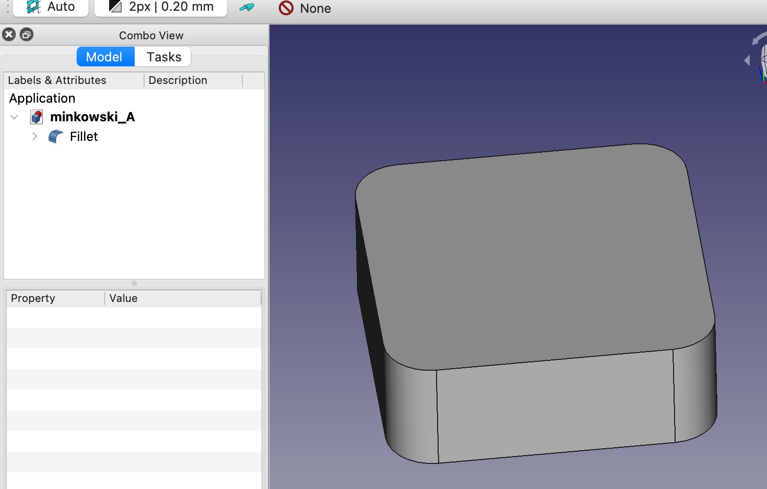

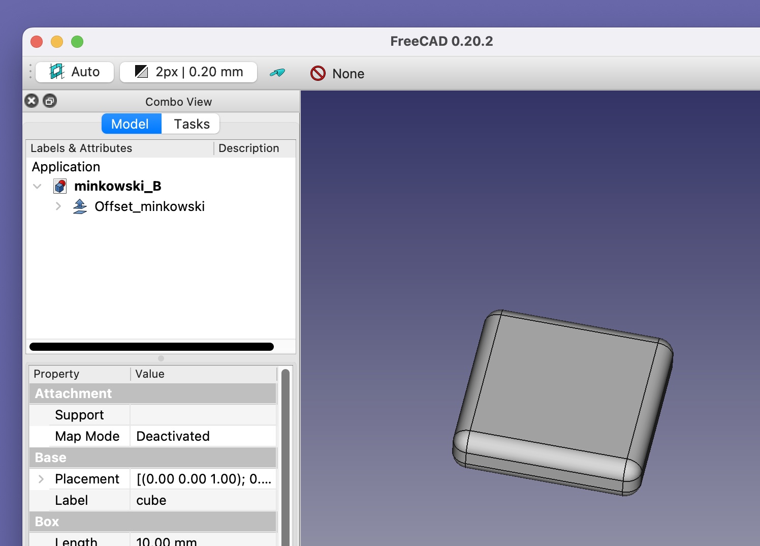

Which using the alternate import gives
i.e. A Brep shape with fully rounded edges.

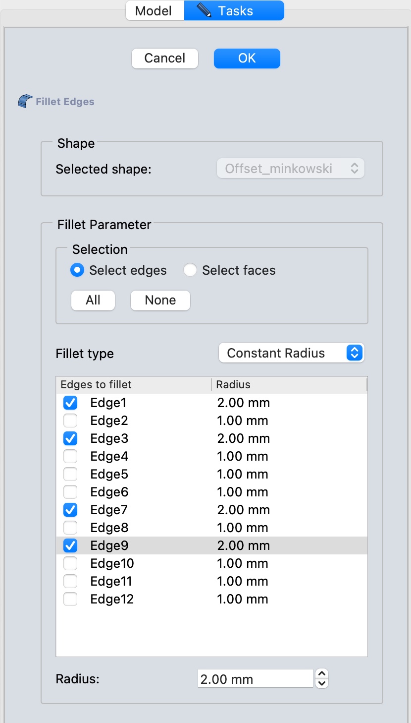

Similarly group() {
    minkowski(convexity = 0) {
        cube(size = [10, 10, 1], center = false);
        cylinder($fn = 50, $fa = 12, $fs = 2, h = 1, r1 = 2, r2 = 2,
center = false);
Produces
Which has fully editable fillets in FreeCAD

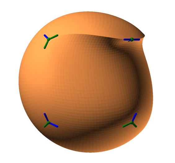

I attach an image with sharp features. The input is a cube with most
normals into obvious directions. Only at the upper right corner,
normals, or rather the resulting directions of half edges, have been
tweaked as indicated by the bars. At the upper left corner, the sharp
feature merges gracefully into a precise sphere.
