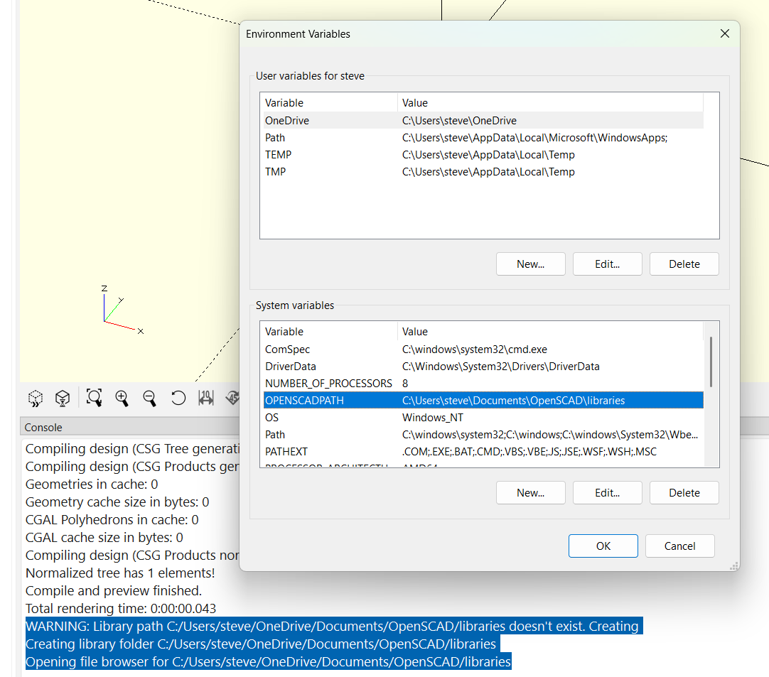

When I used the file/Show Library Folder menu command earlier today, I
got an error message apparently arising from a mismatch between the
contents of my OPENSCADPATH environment variable and the directory that
OpenSCAD tried to use. OpenSCAD then 'helpfully' created the OpenSCAD
file hierarchy that it couldn't find, but actually I don't want any of
my files to be in the location it chose (the OneDrive directory.)
The directory path shown in the error message was
C:/Users/steve/OneDrive/Documents/OpenSCAD/libraries whereas my
OPENSCADPATH is set to C:\Users\steve\Documents\OpenSCAD\libraries
 I notice that there is a switch between / and \ for directory
separators in the two paths but I assume that the bigger issue relates
to the OpenSCAD thinking it needs a /OneDrive/ element that I didn't
specify in the OPENSCADPATH.
What's going on?
Thanks,
Steve

OpenSCAD doesn't know beans about OneDrive.  It asks Windows where your
Documents folder is, Windows tells it, and it creates an OpenSCAD
hierarchy under your Documents folder if it doesn't exist, and then
looks for libraries there.  It seems that your Windows is (as many are)
configured to have your Documents folder on OneDrive.

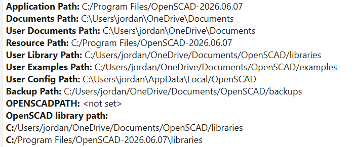

One likely point of confusion:  OpenSCAD does not have a library
folder.  It searches two or more:
  • The folders that your $OPENSCADPATH specifies.
  • (your Documents folder)\OpenSCAD\libraries.
  • (the installation directory)\libraries.
Look at Help/Library Info, under the heading "OpenSCAD library path".
Here's the relevant piece of Help/Library Info on my system.  I don't
have $OPENSCADPATH set, so it doesn't end up in the final search list:

Or set $OPENSCADPATH, put your libraries there, and ignore
Documents/OpenSCAD/libraries.
