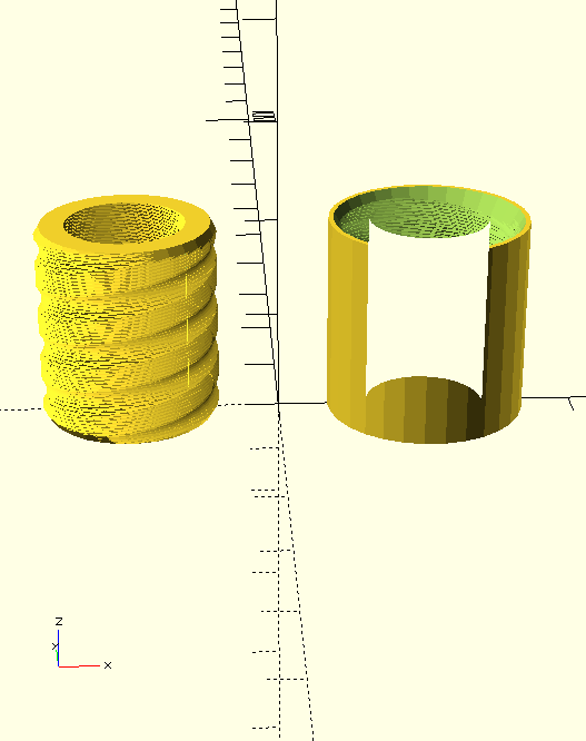

I'm working on a nut/bolt library that renders a little more efficiently
than what I've found on thingiverse so far. Even printed a few prototypes
from the models, and they come out very well, paired nuts and bolts fit
together exactly.
One critical feature to make a thread insert easily from a bolt into a nut
is to have a conical taper into the first thread. Doing that difference()
operation was no problem at first. I decided to try adding an option in the
library for both sides of a nut or bolt thread to be tapered. The nut
doesn't have a problem, but when performing a difference() operation on the
bolt with a cylinder that has a cone cut out of it and inset slightly into
the top & bottom edges of the thread, I get an error when I do the F6 CGAL
render:
ERROR: CGAL error in CGALUtils::applyBinaryOperator difference: CGAL ERROR:
assertion violation! Expr: itl != it->second.end() File:
/opt/mxe/usr/x86_64-w64-mingw32.static/include/CGAL/Nef_3/SNC_external_structure.h
Line: 1102
The rest of the model renders just fine, except without this one
difference() operation performed.
The odd part is that I can do the operation of tapering just the top, or
just the bottom, and no error occurs. If both are differenced from the
thread structure at the same time, this error occurs and no tapering is
produced in the model on either side.
I've attached the bolt-nut.scad library that this error occurs with. The
very last line is the example bolt that produces the error. Changing the
taper_side parameter at the end of the bolt() module call from "both" to
"top" or "bottom" will produce the correct models.
I'm curious if anyone knows how this sort of error can occur, since it is
not due to something like a singularity or non-manifold operation being
created (the usual reason a CGAL binary operation fails), since neither of
the individual operations of creating the top/bottom taper on the thread
creates this error, only when both are done together.
Thanks in advance for any help!

The reason it only fails when both ends are tapered is because the points
of the two tapers overlap each other. The singularity at the point seems to
confuse CGAL. If I truncate the cone like this it works.
module taper_cone_nut(radius=5, angle=60){
height = radius * tan(angle);
translate([0, 0, height / 2])
cylinder(h=height / 2, r1=radius / 2, r2=radius);
I also needed to set convexity in the extrudes to make the preview work.

Hmm, you must have been having a different error then. Changing the taper_cone_nut should not, theoretically, effect the bolt code, since it uses taper_cone_bolt to create the volume that's subtracted on the outer edge of the external bolt threads. I also didn't need to change any convexity settings for mine to work, but that may be since it's recycling geometries from previous renders. It probably does look ugly the first time you load the script, after an initial F6 render even the F5 preview should look cleaner with successive modifications. I'll look into what's going on there though, I think you might have something that doesn't require me to re-work the code much. Thanks! On Fri, Mar 3, 2017 at 1:58 AM, nop head <nop.head@gmail.com> wrote: > The reason it only fails when both ends are tapered is because the points > of the two tapers overlap each other. The singularity at the point seems to > confuse CGAL. If I truncate the cone like this it works. > > module taper_cone_nut(radius=5, angle=60){ > height = radius * tan(angle); > translate([0, 0, height / 2]) > cylinder(h=height / 2, r1=radius / 2, r2=radius); > } > > I also needed to set convexity in the extrudes to make the preview work. > > On 3 March 2017 at 05:11, David Coneff <david.coneff@gmail.com> wrote: > >> I'm working on a nut/bolt library that renders a little more efficiently >> than what I've found on thingiverse so far. Even printed a few prototypes >> from the models, and they come out very well, paired nuts and bolts fit >> together exactly. >> >> One critical feature to make a thread insert easily from a bolt into a >> nut is to have a conical taper into the first thread. Doing that >> difference() operation was no problem at first. I decided to try adding an >> option in the library for both sides of a nut or bolt thread to be tapered. >> The nut doesn't have a problem, but when performing a difference() >> operation on the bolt with a cylinder that has a cone cut out of it and >> inset slightly into the top & bottom edges of the thread, I get an error >> when I do the F6 CGAL render: >> >> Compiling design (CSG Tree generation)... >> >> Rendering Polygon Mesh using CGAL... >> >> ERROR: CGAL error in CGALUtils::applyBinaryOperator difference: CGAL >> ERROR: assertion violation! Expr: itl != it->second.end() File: >> /opt/mxe/usr/x86_64-w64-mingw32.static/include/CGAL/Nef_3/SNC_external_structure.h >> Line: 1102 >> >> >> The rest of the model renders just fine, except without this one >> difference() operation performed. >> >> The odd part is that I can do the operation of tapering just the top, or >> just the bottom, and no error occurs. If both are differenced from the >> thread structure at the same time, this error occurs and no tapering is >> produced in the model on either side. >> >> I've attached the bolt-nut.scad library that this error occurs with. The >> very last line is the example bolt that produces the error. Changing the >> taper_side parameter at the end of the bolt() module call from "both" to >> "top" or "bottom" will produce the correct models. >> >> I'm curious if anyone knows how this sort of error can occur, since it is >> not due to something like a singularity or non-manifold operation being >> created (the usual reason a CGAL binary operation fails), since neither of >> the individual operations of creating the top/bottom taper on the thread >> creates this error, only when both are done together. >> >> Thanks in advance for any help! >> >> - David >> >> >> >> _______________________________________________ >> OpenSCAD mailing list >> Discuss@lists.openscad.org >> http://lists.openscad.org/mailman/listinfo/discuss_lists.openscad.org >> >> > > _______________________________________________ > OpenSCAD mailing list > Discuss@lists.openscad.org > http://lists.openscad.org/mailman/listinfo/discuss_lists.openscad.org > >
Fri, Mar 3, 2017 3:54 PM
Hmm, I must have confused myself with the bug in OpenSCAD that only
displays errors once.
I have never known preview to work without setting convexity in
linear_extrude unless there are no subsequent CSG ops. It is a complete
mess in preview without convexity on my system.
Removing the knife edges from taper_cone_bolt seems to fix it. You don't
want to do CSG ops with coincident faces and vertexes unless they are
absolutely coincident in several number representation used by OpenSCAD.
So if you make a knife edge by subtracting a cone from a cylinder that are
the same size and then subtract that from a bolt that is the same size you
are going to get problems.
There was a similar issue recently where hair was made by subtracting a
head sphere from a cylinder creating a knife edge and then that was unioned
with the head. Knife edges that just touch something create a non-manifold
shape at best. They need to overlap slightly or just miss slightly.

What convexity value did you use? I found setting it manually in just one of them made the model a lot more "weighty" for rotating in preview mode. What I liked about this construction method is that the original code I used produces a model that may look ugly in F5 preview, but with an appropriate $fn=30 or higher it renders just fine for making an STL model. Most of the other screw libraries I've ran into on thingiverse use a construction method that leads to highly detailed, but also very computationally expensive models for even an example 2-revolution thread even in preview mode. On Fri, Mar 3, 2017 at 8:26 AM, David Coneff <david.coneff@gmail.com> wrote: > Hmm, you must have been having a different error then. Changing the > taper_cone_nut should not, theoretically, effect the bolt code, since it > uses taper_cone_bolt to create the volume that's subtracted on the outer > edge of the external bolt threads. > > I also didn't need to change any convexity settings for mine to work, but > that may be since it's recycling geometries from previous renders. It > probably does look ugly the first time you load the script, after an > initial F6 render even the F5 preview should look cleaner with successive > modifications. > > I'll look into what's going on there though, I think you might have > something that doesn't require me to re-work the code much. Thanks! > > On Fri, Mar 3, 2017 at 1:58 AM, nop head <nop.head@gmail.com> wrote: > >> The reason it only fails when both ends are tapered is because the points >> of the two tapers overlap each other. The singularity at the point seems to >> confuse CGAL. If I truncate the cone like this it works. >> >> module taper_cone_nut(radius=5, angle=60){ >> height = radius * tan(angle); >> translate([0, 0, height / 2]) >> cylinder(h=height / 2, r1=radius / 2, r2=radius); >> } >> >> I also needed to set convexity in the extrudes to make the preview work. >> >> On 3 March 2017 at 05:11, David Coneff <david.coneff@gmail.com> wrote: >> >>> I'm working on a nut/bolt library that renders a little more efficiently >>> than what I've found on thingiverse so far. Even printed a few prototypes >>> from the models, and they come out very well, paired nuts and bolts fit >>> together exactly. >>> >>> One critical feature to make a thread insert easily from a bolt into a >>> nut is to have a conical taper into the first thread. Doing that >>> difference() operation was no problem at first. I decided to try adding an >>> option in the library for both sides of a nut or bolt thread to be tapered. >>> The nut doesn't have a problem, but when performing a difference() >>> operation on the bolt with a cylinder that has a cone cut out of it and >>> inset slightly into the top & bottom edges of the thread, I get an error >>> when I do the F6 CGAL render: >>> >>> Compiling design (CSG Tree generation)... >>> >>> Rendering Polygon Mesh using CGAL... >>> >>> ERROR: CGAL error in CGALUtils::applyBinaryOperator difference: CGAL >>> ERROR: assertion violation! Expr: itl != it->second.end() File: >>> /opt/mxe/usr/x86_64-w64-mingw32.static/include/CGAL/Nef_3/SNC_external_structure.h >>> Line: 1102 >>> >>> >>> The rest of the model renders just fine, except without this one >>> difference() operation performed. >>> >>> The odd part is that I can do the operation of tapering just the top, or >>> just the bottom, and no error occurs. If both are differenced from the >>> thread structure at the same time, this error occurs and no tapering is >>> produced in the model on either side. >>> >>> I've attached the bolt-nut.scad library that this error occurs with. The >>> very last line is the example bolt that produces the error. Changing the >>> taper_side parameter at the end of the bolt() module call from "both" to >>> "top" or "bottom" will produce the correct models. >>> >>> I'm curious if anyone knows how this sort of error can occur, since it >>> is not due to something like a singularity or non-manifold operation being >>> created (the usual reason a CGAL binary operation fails), since neither of >>> the individual operations of creating the top/bottom taper on the thread >>> creates this error, only when both are done together. >>> >>> Thanks in advance for any help! >>> >>> - David >>> >>> >>> >>> _______________________________________________ >>> OpenSCAD mailing list >>> Discuss@lists.openscad.org >>> http://lists.openscad.org/mailman/listinfo/discuss_lists.openscad.org >>> >>> >> >> _______________________________________________ >> OpenSCAD mailing list >> Discuss@lists.openscad.org >> http://lists.openscad.org/mailman/listinfo/discuss_lists.openscad.org >> >> >
Fri, Mar 3, 2017 3:59 PM
I set convexity to 4. Here is the difference it makes with it set just on
the bolt.

Yeah, I suppose I should have been more careful with the cone part of the
code. After trying out your example I saw that it resolved the error,
however, the F6 render still didn't result in a tapered bolt thread. I
tried adapting that modification to the taper_cone_bolt() module, but
there's something wrong with how I did it because the thread is not tapered
correctly.. something to do with the interaction of the translation of the
taper_cone_bolt's height, the taper_angle still looks correct.
the bolt.
points of the two tapers overlap each other. The singularity at the point
seems to confuse CGAL. If I truncate the cone like this it works.

You got fooled by the same bug as me. You have to flush the caches to see
the error again. This seems to work.
module taper_cone_bolt(radius=5, angle=60){
height = radius * tan(angle);              // note that height
approaches infinity as angle approaches 90. putting in 90 will create a
nonsensical result, 89 works fine though.
cylinder(h=height + 0.01, r=radius);          // cylinder that
matches the maximum outer radius of the threads
cylinder(h=height,r1=radius,r2=0);      // subtracted cone
It avoids the point of the cone touching the top.
on the bolt.
work.
