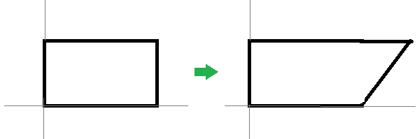

Is there a way in OpenSCAD to distort a shape based on some kind of
function that takes the x,y,z coordinates of the vertices and modifies
them to produce a new x,y,z?
Specifically, I have a shape that I want to stretch in the x direction
by a percentage that depends on the point's y value. It would produce
something like the distortion in the sketch below - except that my shape
is more complex than a simple rectangle or cuboid. I've had a look at
multmatrix but even with that I can't see a direct way to do what I want.
Any suggestions?
The answer is no, not in OpenSCAD.
The best you can do is save the shape to a file, such as e.g. OBJ and
then modify the vertices in separate software. Example
https://gist.github.com/arnholm/af72c7d0790bb3d72e6bdf29c7aac1ed

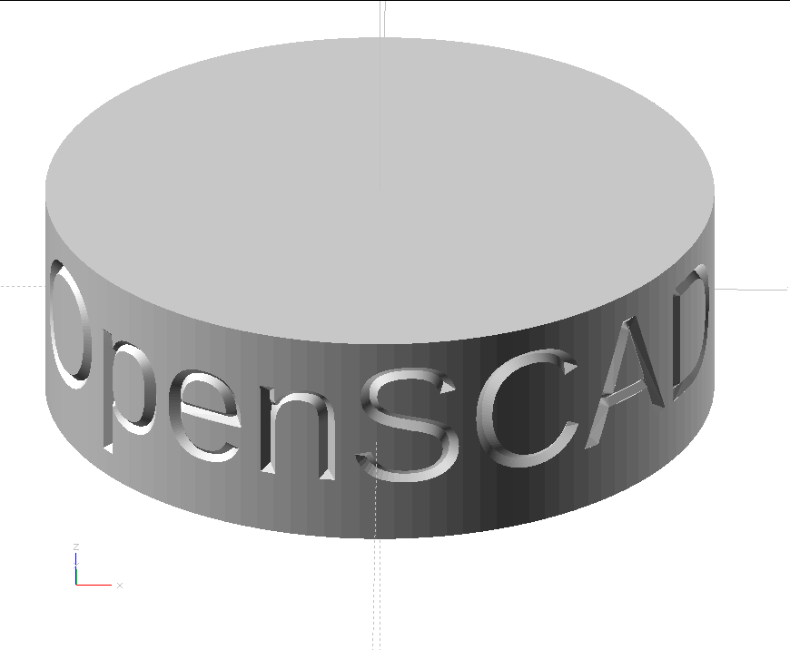

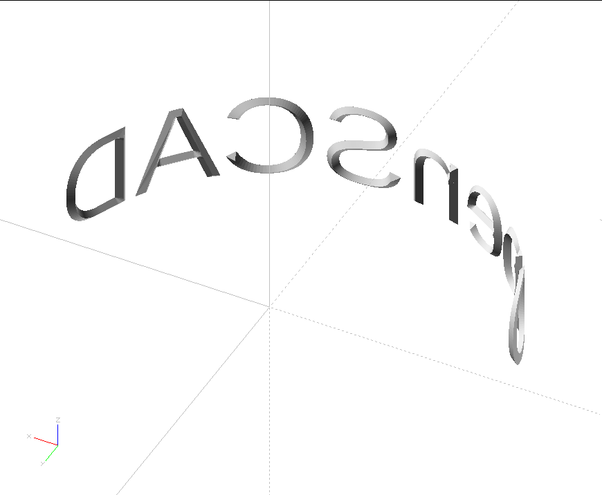

Just a quick update on my inquiry about distorting vertices: by
combining advice from Carsten and Glenn, I was able to solve one of my
other problems - finding an easy way to engrave text on a cylinder and
get it looking good. Until I've either used positioned letters manually
or used a clumsy and process-intensive method involving creating dozens
of thin slices of  a flat engraved shape, and standing them up to be
arranged as the facets of a cylinder.
Instead, today I used the new roof feature to turn text into 3D and then
scaled it by -1 in the z direction to create 'negative valleys' instead
of hills. I then exported the shape to STL and retrieved it as a a set
of points and faces using the converter at
https://raviriley.github.io/STL-to-OpenSCAD-Converter/   (note: the
converter produces faces that are wound in the opposite direction to
objects created within OpenSCAD, causing the subtraction to fail. You
may need to reverse the order of all the individual faces.)
A fairly simple rule applied to the points displaces them so that the
original flat text polyhedron is bent into a ring, which I then
subtracted from a cylinder using 'difference' to get the final shape.
Overall, it's easier and quicker than the ways I've done it before, and
a similar approach would work for raised text.

looks similar to this one ...
https://www.reddit.com/r/pythonscad/comments/1cug84c/new_function_to_wrap_objects_around_a_cylinder/
main challenge when "bending" something is to split straight lines often
enough to be able to establish equidistant rounding
ps:  no external tool needed
original flat text polyhedron is bent into a ring, which I then subtracted
Overall, it's easier and quicker than the ways I've done it before, and a
Steve
