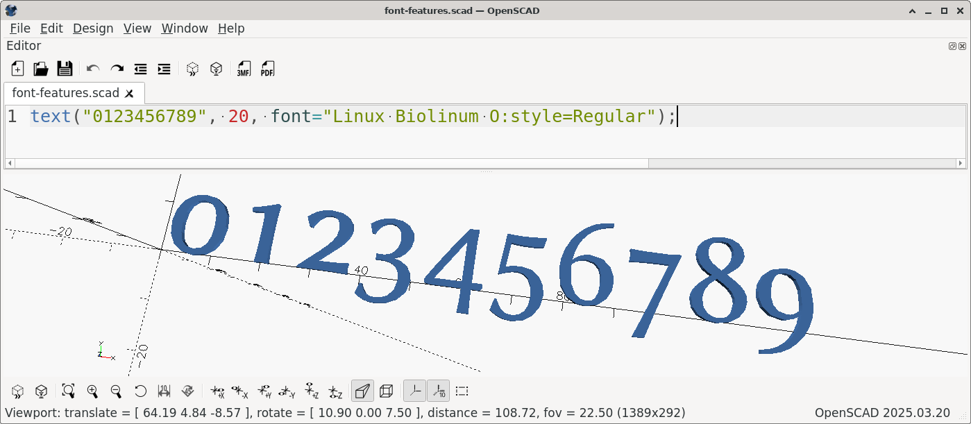

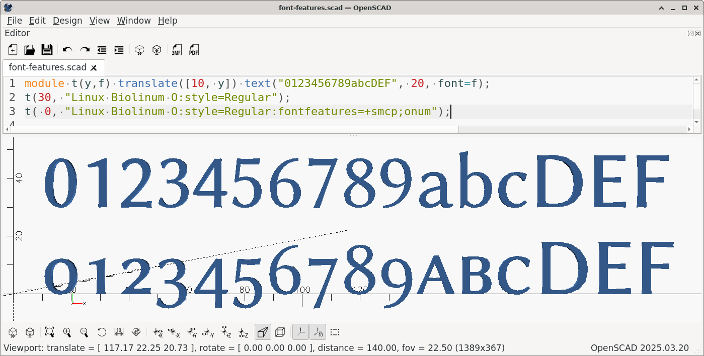

On 3/20/25 05:19, Jordan Brown via Discuss wrote:
Fontconfig specifications can include a fontfeatures tag, probably in
the form ":fontfeatures=+onum".
Yup, that works. Looks like multiple flags need to be separated by
something else than ":" and ",". I've used ";" and that works to
enable both old numbers and small caps (see screenshot).
