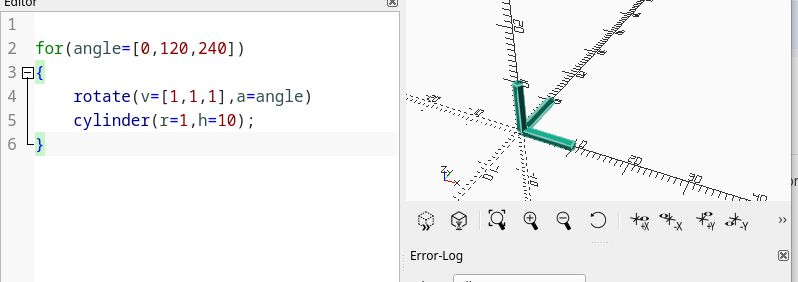

Hi all together
I believe, that openscad can YET already  rotate an object around an
arbitrary axis!
for(angle=[0,120,240])
rotate(v=[1,1,1],a=angle)
cylinder(r=1,h=10);
this turns an cylinder showing up into 3 different directions showing up,
front,  and right.
i can imagine this like rotating an  object around a cube's corner
code for that is already present in src/core/Transform.cc

Wow!  I have been using OpenSCAD for a few years now, and didn't realize
this other way using Rotate.
Here is some documentation for it:
https://en.wikibooks.org/wiki/OpenSCAD_User_Manual/Transformations#rotate
Thanks all!
