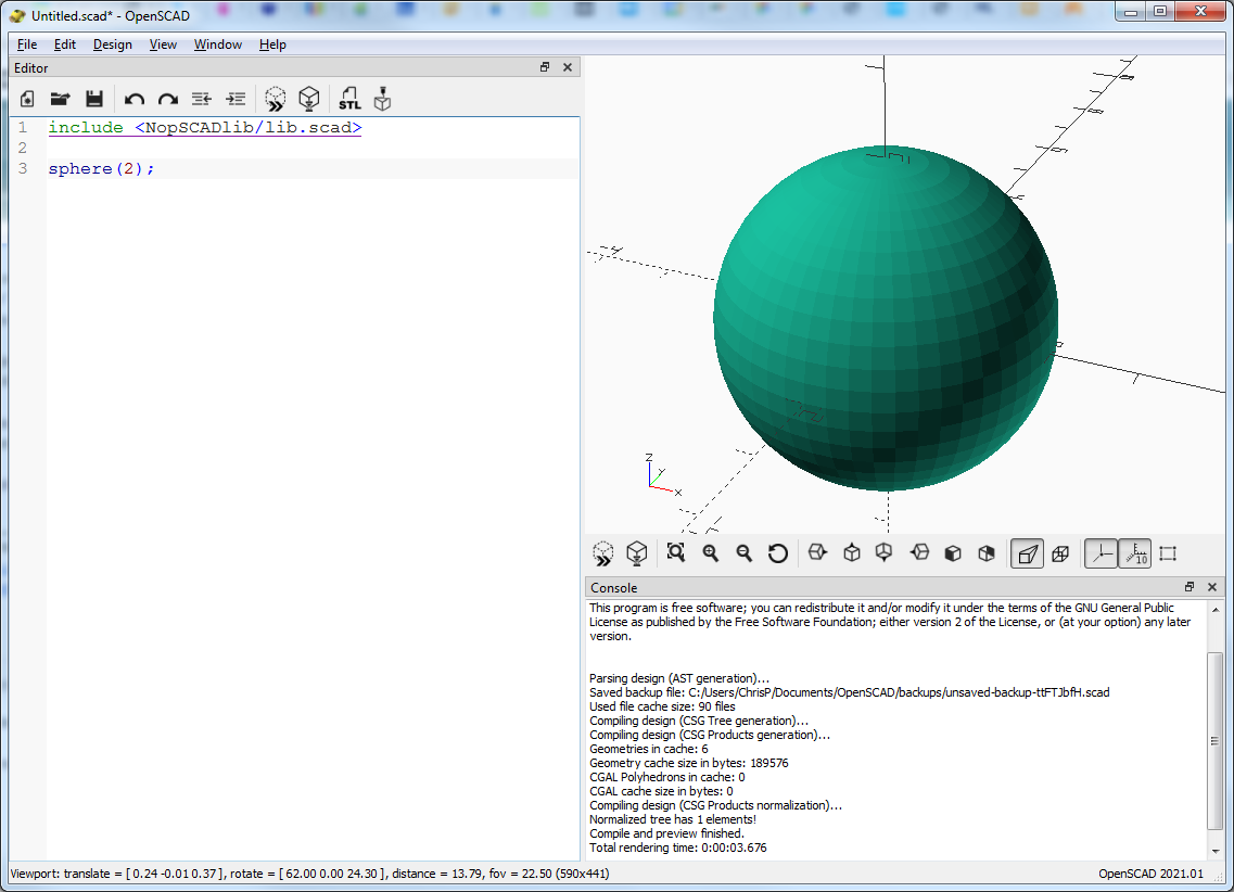

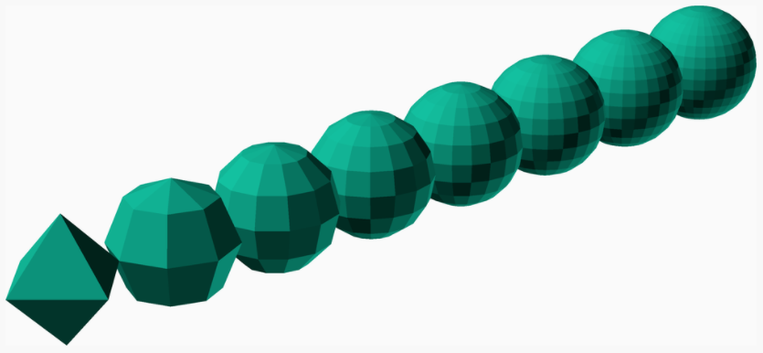

I think that has been coded but simply rotate_extruding a semicircle with
$fn set to a multiple of four gives a sphere with points on the poles. See
https://github.com/nophead/NopSCADlib#Sphere
I override the built in sphere with this to get hulls with the correct
dimensions when the spheres are placed in the corners.

Does a geodesic sphere have vertices on the 6 semi-axis lines? I think that
is a requirement when using spheres to make accurate corners.
There is no reason why a small sphere can't be pretty if $fa is set.
that is a requirement when using spheres to make accurate corners.
Yes, if it's based on the octahedron. The geodesic sphere based on the
icosahedron doesn't have that property. In BOSL2, you may find a module
called spheroid that is able to draw geodesic spheres in both styles.
https://github.com/revarbat/BOSL2/wiki/shapes.scad#spheroid

Sat, Jan 30, 2021 10:54 AM
In BOSL2, the command spheroid(d=100, type=“octa”); will make a sphere based on a subdivided octahedron, which guarantees maxima/minima on all three axes. With type=“icosa”, it subdivides an icosahedron, but maxima/minima on axes is only guaranteed for $fn that are modulo to both 4 and 5.
-Revar
