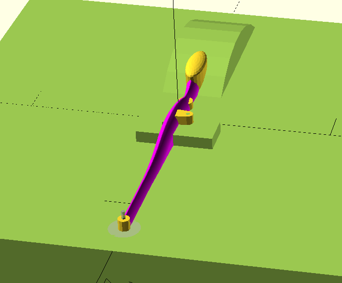

I build shapes for turtle3d in turtle (2d)
Then I diffs some and preview shows empty.
I guess it not solid.

Your model is ending up inside-out, and that's really messing up the
previewer.
If you look at it with View/Thrown Together, you can see that the main
body of the model is magenta... that's bad; it means that we're looking
at what is supposed to be the back side of the faces.

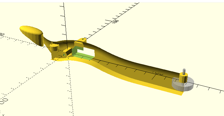

This problem derives from ushape4 being wound backwards.  Reversing it,
e.g. via
ushape4 = reverse([....]);
solves most of your problems.
I don't know all of the rules for sweep, and in particular I don't know
how to know which way is "correct".  In this particular case, you're
winding it counter-clockwise, and it needs to be clockwise, but I don't
know if that's different for other sweeps, e.g. a sweep in the opposite
direction.
Perhaps Adrian could chime in.

Yes! it works now. I am understanding more
Thank you!
