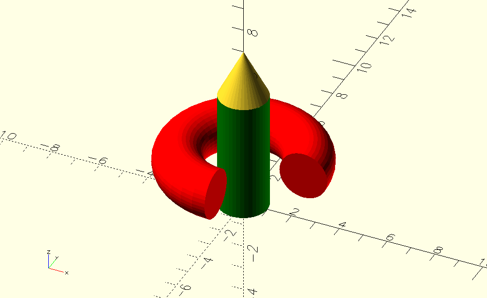

Hello Everyone,
I believe I have the namespace keyword fully implemented and the using
keyword working for functions and modules. Singular references (i.e.
namespace_name::variable) and looking up variables are next. It also
seems include works inside a namespace, which shouldn't be surprising as
it just copy-pastes the file contents while parsing, but I haven't
really thought about this.
I'm not sure if you can download the builds run by the checks, but all
builds succeeded and the only failing tests are the two I've added for
not-yet-complete functionality.
https://github.com/openscad/openscad/pull/6131
  • Cory Cross
using-demos.scad:
// Break circle
module circle() {}
$fn=40;
namespace apple {
  function only_in_apple() = "red";
  function what_color() = only_in_apple();
  module worm(ring_d=2) {
    color(what_color())
      rotate_extrude(angle=270)
        translate([ring_d,0,0])
            circle(1);
namespace banana {
  include <b0rk.scad>
  using apple;
  my_color = "green";
  function what_color() = my_color;
  module tall() {
    my_color="black"; // As intended, not used.
    color(what_color()) cylinder(h=5,r=1);
    translate([0,0,2]) worm(2.5);
    if(b0rk) translate([0,0,5]) cylinder(h=2,r1=1,r2=0);
using banana;
echo(my_color); // Assignment lookup TBD
echo(what_color());
tall(); // Center is green, worm is red.
echo(only_in_apple()); // Expect unknown function and that's what happens!
b0rk.scad:
b0rk = true;

Cory Cross
Fri, Aug 29, 2025 8:29 PM
I forgot some details about semantics; the long version is in Issue#522
https://github.com/openscad/openscad/issues/522, the short version is:
  1. Namespaces can only be at top level (no nesting).
  2. They are evaluated before evaluating the source file. (So all files
    are read/included, namespaces are evaluated in the order first
    mentioned, then source file starts being evaluated)
    1. This means $special variables in the source file do not affect
      namespace assignments
    2. Builtins are in scope for namespace evaluations
    3. Namespace assignments cannot use values, functions, or modules
      from namespaces first declared after their own; or transitively
      via functions. (This is existing semantics: function x() = x;
      y=x(); x=1; does not work)
    4. Namespace functions and modules can use values, functions, and
      modules from any namespace
    5. Namespace functions and modules are affected by $special
      variables when called and can set them for calling other
  3. Namespace names have their own environment and cannot be assigned to
    variables (this could be added later).
  4. namespace can be repeated; it's treated as if you concatenated the
    bodies of all namespace blocks into the first one.
  5. Existing OpenSCAD semantics should apply: repeated variable
    definitions act is if the last one was written at the location of
    the first definition, repeated function/module definition will
    replace the earlier ones.
  6. Namespaces are evaluated in order of their first mention. (namespace
    a{} namespace b{using a; y=x;} namespace a{x=1;} will assign 1 to y)
  7. Namespaces in use<>d files may or may not work. Haven't tried.

Am I missing something? The place I think of namespaces being useful is for defining libraries. I don’t see how this syntax is practical for a library as large as BOSL2 or NopHead’s.
-Bob

Cory Cross
Sat, Aug 30, 2025 1:25 AM
I think you missed my email sent 27 August @ 14:53 Pacific.
With this syntax, most of bosl2 could be put in one namespace with 3 lines:
namespace bosl2 {
Now, as I wrote in the other message, I think per-file namespaces make
more sense and I outline exactly why adding the namespace keyword is
less work and a better result than abusing object().
  • Cory

using-demos.scad:
// Break circle
module circle() {}
$fn=40;
namespace apple {
    color(what_color())
            circle(1);
namespace banana {
  include <b0rk.scad>
  using apple;
  my_color = "green";
  module tall() {
using banana;
echo(what_color());
happens!
b0rk.scad:
b0rk = true;
<using-demos.png>

using-demos.scad:
// Break circle
module circle() {}
$fn=40;
namespace apple {
color(what_color())
circle(1);
namespace banana {
include <b0rk.scad>
using apple;
my_color = "green";
module tall() {
using banana;
echo(what_color());
b0rk.scad:
b0rk = true;
<using-demos.png>

 using-demos.scad:
 // Break circle
 module circle() {}
 $fn=40;
 namespace apple {
     color(what_color())
             circle(1);
 namespace banana {
   include <b0rk.scad>
   using apple;
   my_color = "green";
   module tall() {
 using banana;
 echo(what_color());
 what happens!
 b0rk.scad:
 b0rk = true;
 <using-demos.png>
