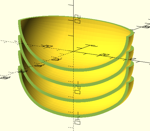

Here's an example of the above approach (similar to what Sanjeev did but an
actual egg shape) using BOSL2:
module egg_bowl()
r1 = 25; r2 = 18; R = 65; thickness=2;
length = floor(lookup($t, [[0,55], [0.5,90], [1,55]]));
yrot(90)
right_half()
rotate_extrude($fn=64)
right_half(planar=true)
zrot(90)
egg(80+2*thickness,r1+thickness,r2+thickness,R+thickness,$fn=180);
egg(80,r1,r2,R,$fn=180);
back_half()
zcopies(spacing=10, n=4) egg_bowl();
And the result:

I don't really understand the problem you're trying to solve. Egg shapes are stackable because of their shape. (Though a simple egg shape doesn't have a flat bottom so that it will actually sit stably on the table. You can easily make stackable shapes based on any profile by rotating the profile---eggs do have rotational symmetry around one axis. If you have a way to make a desired shape with any width then you can difference two of them and rotate to get a stackable shape. But it seems like you're after something else. Here's an example of the above approach (similar to what Sanjeev did but an actual egg shape) using BOSL2: include <BOSL2/std.scad> module egg_bowl() { r1 = 25; r2 = 18; R = 65; thickness=2; length = floor(lookup($t, [[0,55], [0.5,90], [1,55]])); yrot(90) right_half() rotate_extrude($fn=64) right_half(planar=true) zrot(90) difference(){ egg(80+2*thickness,r1+thickness,r2+thickness,R+thickness,$fn=180); egg(80,r1,r2,R,$fn=180); } } back_half() zcopies(spacing=10, n=4) egg_bowl(); And the result: [image: image.png] On Sat, Jun 8, 2024 at 9:57 PM Nathan Sokalski via Discuss < discuss@lists.openscad.org> wrote: > I am looking to make egg-shaped bowls for dyeing Easter Eggs. I have > created a 2D module that creates the outline of (or filled) the egg shape I > want, but in order to make them stackable the sides would need to be > sloped. rotate_extrude is not appropriate for this, since I am making an > egg shape (not a circular shape). I also looked at using the scale > attribute of linear_extrude, but that seemed very confusing, and did not > seem to make all sides slope equally. What I would really like to do is > create 2 2D shapes & have a non-vertical wall wrapped around them. Does > anybody have any advice on making stackable non-standard shapes? Thanks! > > Nathan Sokalski > njsokalski@hotmail.com > _______________________________________________ > OpenSCAD mailing list > To unsubscribe send an email to discuss-leave@lists.openscad.org >
