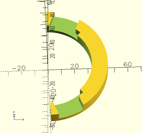

I am in the process of replacing a failed, shop made tally switch
assembly on the head gear shift of my grizzly Go704 milling machine.
Strangely, it took a decade for the shoe-goo I built it with to migrate
and lock one of the switches in the n.o. position.
This consists of two mini microswitches with roller tipped levers, which
drop into a notch carved in the skirt of the knob that turns to shift
the gears.
This would be considerably easier to if I had a quick method of specing
the switch location in a half moon shaped printed bracket if I had a way
to translate the switches locations using polar-rectangular input so the
radius in mm and the degree was that starting data. But that is
something I was never in the same room with until linuxcnc. Where it has
been handier than sliced bread.  As far as I know, openscad does not do
those conversions.
Can it be done, but I haven't spotted it?  If so, how?  I suspect sin
and cos are somehow involved.

I think this would do it:
rotate(angle) translate([r, 0])
Pix attached.  Some variations of this theme worked fine. the extra
notches are lever roller clearance when depressed by the knob rim.
They are longer than the switch body. Thank you nop head.

To convert polar coordinates (r, Θ) to rectangular coordinates (x, y):
  • x = r cos(Θ)
  • y = r sin(Θ)
To convert rectangular coordinates (x, y) to polar coordinates (r, Θ):
  • r = sqrt(x^2 + y^2)
  • Θ = atan(y/x)

In PythonSCAD, rotate got a ref parameter in the latest build. Basically you can not write: rotated = shape.rotate([0,0,10], ref=[5,5,0]) # basically: specifying the center of rotation. Internally i case ref is specified will add 2 additional translation nodes On Sat, Sep 20, 2025 at 11:49 PM gene heskett <gheskett@shentel.net> wrote: > On 9/20/25 10:19, Guenther Sohler wrote: > > It appears to me that you want to rotate a point around ALPHA with a > given > > CENTER position ? > Basically yes. nop-head gave me something that works nicely. Now I > suspect the 1/2 drop of superglue I'm fixing the switches mounting with, > is migrating into the switches, giving me a semi false high R contact > closure that should go away when the switch discovers it is switching a > 12 volt logic signal. That is not quite a dry circuit but I'm letting > the glue cure to be sure before I commit to installing it.. > > Thank you Guenther. > > On Sat, Sep 20, 2025 at 3:28 PM gene heskett via Discuss < > > discuss@lists.openscad.org> wrote: > > > >> I am in the process of replacing a failed, shop made tally switch > assembly > >> on the head gear shift of my grizzly Go704 milling machine. Strangely, > it > >> took a decade for the shoe-goo I built it with to migrate and lock one > of > >> the switches in the n.o. position. > >> > >> This consists of two mini microswitches with roller tipped levers, which > >> drop into a notch carved in the skirt of the knob that turns to shift > the > >> gears. > >> > >> This would be considerably easier to if I had a quick method of specing > >> the switch location in a half moon shaped printed bracket if I had a > way to > >> translate the switches locations using polar-rectangular input so the > >> radius in mm and the degree was that starting data. But that is > something I > >> was never in the same room with until linuxcnc. Where it has been > handier > >> than sliced bread. As far as I know, openscad does not do those > >> conversions. > >> > >> Can it be done, but I haven't spotted it? If so, how? I suspect sin > and > >> cos are somehow involved. > >> > >> Thanks all. > >> > >> Cheers, gene Heskett, CET. > >> > >> -- > >> "There are four boxes to be used in defense of liberty: > >> soap, ballot, jury, and ammo. Please use in that order." > >> -Ed Howdershelt (Author, 1940) > >> If we desire respect for the law, we must first make the law > respectable. > >> - Louis D. Brandeis > >> > >> _______________________________________________ > >> OpenSCAD mailing list > >> To unsubscribe send an email to discuss-leave@lists.openscad.org > > Cheers, Gene Heskett, CET. > -- > "There are four boxes to be used in defense of liberty: > soap, ballot, jury, and ammo. Please use in that order." > -Ed Howdershelt (Author, 1940) > If we desire respect for the law, we must first make the law respectable. > - Louis D. Brandeis > > >
Mon, Sep 22, 2025 12:13 PM
On Sat, Sep 20, 2025 at 11:49 PM gene heskett gheskett@shentel.net wrote:
Thank you Guenther.
