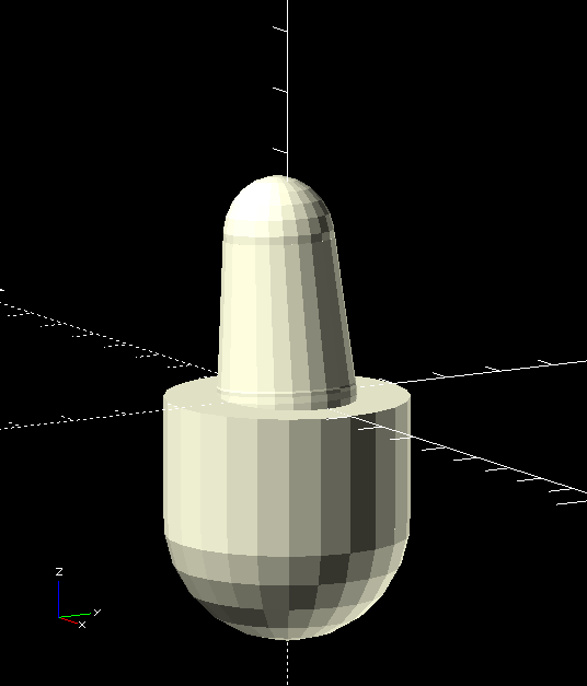

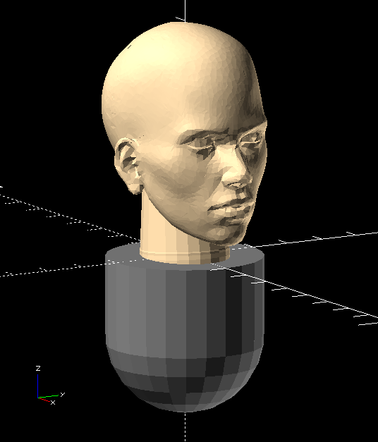

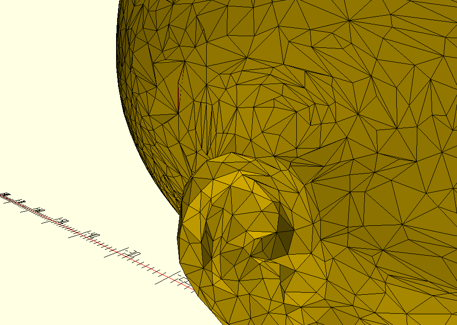

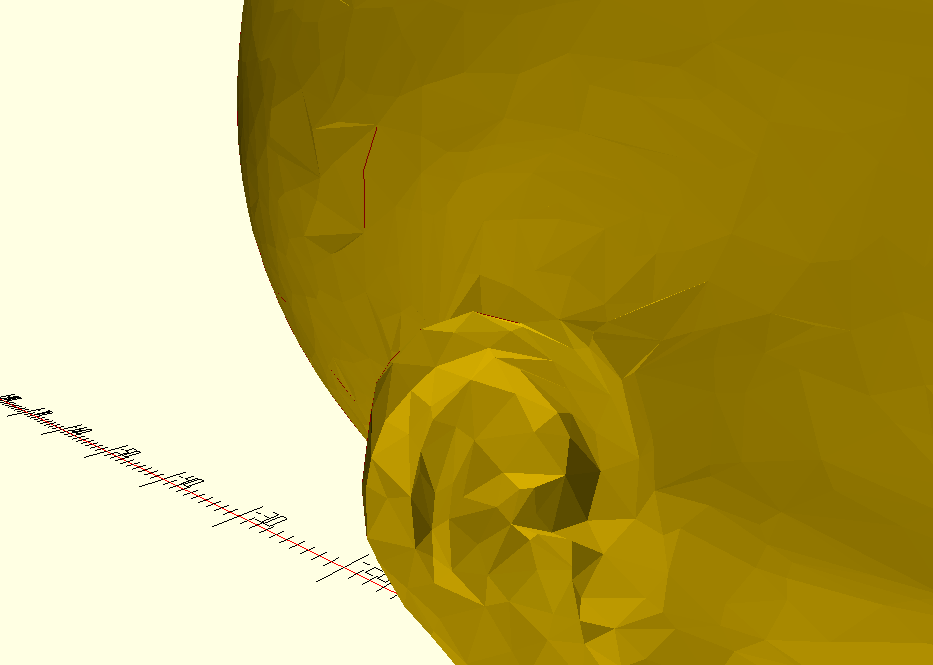

I have OpenSCAD 2015.3-2. The STL was repaired in MS 3D Builder, and again
with NetFabb Online Service. STL, and pictures of error attached.
Getting Error:
violation! Expr: e->incident_sface() != SFace_const_handle() File:
/opt/mxe/usr/x86_64-w64-mingw32.static/include/CGAL/Nef_S2/SM_const_decorator.h
Line: 326
A google search revealed: https://github.com/openscad/openscad/issues/1090
Any tips to getting this to work?
Thank you very much,
Ari M. Diacou

There are several issues with this STL file, automatic repair is
unlikely to work. In short there are overlapping faces, so it cannot be
interpreted as 2-manifold.
One example is shown in the attached 2 images, where one of the overlaps
is indicated (there are several others). I think you will have to fix
the problem in the software that generated the original head model.
