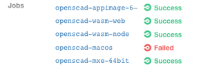

I've spent multiple days now trying to get the Openscad build working on MacOS. I tried home-brew dependencies but that craters on requiring an old perl version that is no longer in Xcode. I tried building the dependencies, which ran into hidapi bugs. After fixing these something else popped ip that I fixed but it did not stop.
Ok, well, I thought, then I just compile it on Linux and run it with a remote desktop. When also a build in a fresh Ubuntu docker container ran in errors I got a bit desperate.
Then I thought, how are they building it on Github? So I cloned the repository, got an account at CircleCI and happily waited for my first build to finish:
The universe hates me ...
How on earth does anybody get this build on MacOS? I think I have some good contributions lined up but if I can't test it myself I won't be able to make PRs.

On Jun 20, 2025, at 08:43, Peter Kriens via Discuss discuss@lists.openscad.org wrote:
What’s the error message in question?
This is how we build daily on various versions of macOS and Xcode.
Caveat: If your OS version or Xcode is > 3 years or so old, it might not be supported.
What error message do you get from the hidapi build?
This is also ran almost daily, so if you discover something, we should fix it.
Building from scratch on CircleCI will take some time, as the dependency building will time out the CircleCI runner and fail. This will happen until we’ve established a cache of all built dependencies. The only solution right now is to retry the build a few times until it goes green. From then on it will work, as long as you refresh the build often enough to keep the CircleCI cache alive (a build every few weeks should be enough).
For fixing the build issuesm the best bet is to paste concrete error messages into a GitHub ticket for each individual issue so we can triage it.

Sorry for ranting :-( it’s warm here.
Where can I find the IRC channel? I’ll start there.
I’m running the beta version of macOS 15.5 on an M1 and XCode, 16.4.
Thanks for the quick response! (And for staying nice ;-)
I see from the logs that you found it.
Beta may be a challenge, but 15.5 proper is out now.
You may be the first one to use Xcode 16.4 - I’ll give it a spin.

Just want to apologize to the Marius Kintel and any other people involved in the build.
I just got it build on my machine with the help of Marius. It turns out the mistakes were on my system. After we corrected them the build ran fine.
Thanks for all the help, and promise to be a bit more humble next time ...
