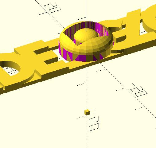

Hello,
I was trying to make a Customizer for Thingiverse.  I couldn't import STL
files on Customizer, so I made a C++ program to convert STL files to
polyhedron()s.  However, my renderer gives me errors whenever I try to show
two polyhedrons()s in the same file.
If you look at the file I uploaded, you will see there are two modules with
polyhedrons in them, both of which are called.  If you call only one of
them, it renders as it should.  But if you try to render both of them, it
renders nothing.  How do I render them both at once?
In the meantime,  I decided to throw everything into one polyhedron()
https://www.thingiverse.com/thing:4422840  , with variables to control
placement and size and all that.  I had my C++ program assist me in this
though, as I don't have the skill to do it entirely by hand

Not rendering multiple objects is generally an indicator of cgal errors in
the stl. If there is only one object, it doesn't go through cgal

CGAL errors are usually a bad STL (non manifold and/or self intersections -
google these terms) or similarly badly formed polygon/polyhedron.
You will generally NOT get a CGAL error if you render one object, because
CGAL gets called to union() defference() etc.
A good test is to add cube(1); to the object you have issues with, that
forces a union() so CGAL gets called.

adding a cube(1) F5 then View/Thrown-together shows:
Purple is an inverted face. The rest of the object looks OK.

Thanks!  I tried rendering two manually programmed cubes side by side, and I
had no CGAL errors.  I even checked my models in Blender for non-manifold
geometry.  It only had the non-manifold in the pic above.  I also repaired
the geometry and reuploaded the Thingiverse file.
From now on, I will always use Blender to check if my objects are manifold
before importing them into OpenSCAD
