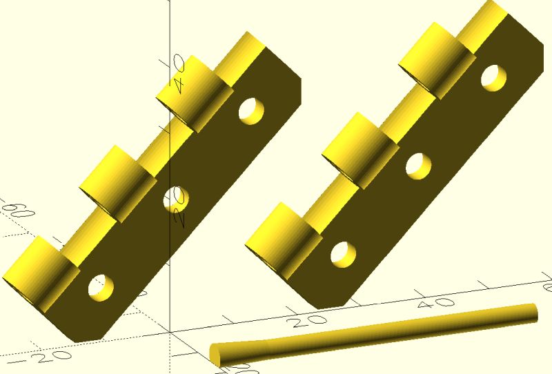

Here is a simple hinge, parametric, of course.
The code that I have attached, would be fairly easy to translate into
openscad, if interested.
This prints well, and the 45 degree angle means no supports and improved
strength.  The year old, open spool of petg, was a bit wet, hence the
high tolerance value, but it printed fine with a couple of mouse
ears. compared to printing vertically .
