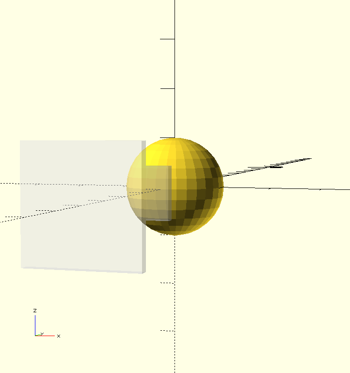

I made a small example and found it only goes wrong if the transparency is
created by the % operator. If it is made with the color module it works.
sphere(10);
translate([0, -20, 0])
%cube([10, 2, 10], center = true);
translate([0, -50, 0])
color("white", 0.5)
cube([20, 2, 20], center = true);
If both transparencies are created with % then it works. So I think it is
an order issue after all. It looks like the % operator trees are rendered
later than the rest. That works if you don't have any other transparent
objects but not if you have any made with color that are in front.
