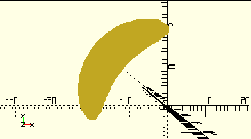

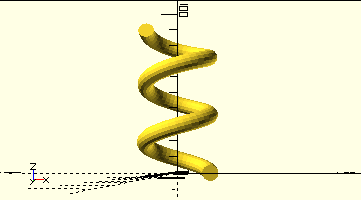

No, but a note:  you might think that linear_extrude with a twist is a
good way to generate helix-like shapes, but it really isn't.  The
problem is that you usually want to specify a cross-section across the
helix - nearly, but not precisely, a vertical cross-section, while what
you would have to supply with linear_extrude is a horizontal cross-section.
To get a helix with a round cross-section like this:
what you need to give to linear_extrude is a shape like this:
I'm sure that one of the mathematicians could tell you how to generate
that shape - I sure can't.  I generated it by using a sweep function to
create the helix, and then taking a cross section of the helix.
Here's that helix, using BOSL2's path_sweep module:
r = 20;
path_sweep(circle(5), [
    for (i=[0:10:900]) [ r*cos(i), r*sin(i), i/10 ]
On 9/13/2022 3:14 PM, laich2@gmail.com wrote: > > Anyone know where I can get the OpenSCAD model of the “Helical Spring” > animation in the *linear_extrude* section? > (https://en.wikibooks.org/wiki/OpenSCAD_User_Manual/Using_the_2D_Subsystem#linear_extrude) > No, but a note:  you might think that linear_extrude with a twist is a good way to generate helix-like shapes, but it really isn't.  The problem is that you usually want to specify a cross-section across the helix - nearly, but not precisely, a vertical cross-section, while what you would have to supply with linear_extrude is a horizontal cross-section. To get a helix with a round cross-section like this: what you need to give to linear_extrude is a shape like this: I'm sure that one of the mathematicians could tell you how to generate that shape - I sure can't.  I generated it by using a sweep function to create the helix, and then taking a cross section of the helix. Here's that helix, using BOSL2's path_sweep module: include <BOSL2/std.scad> r = 20; path_sweep(circle(5), [ for (i=[0:10:900]) [ r*cos(i), r*sin(i), i/10 ] ]);

If you're going to use BOSL2, then spiral_sweep() already exists for just this purpose:
spiral_sweep(circle(5), h=90, r=20, turns=2.5);
<Esv568UuTkLejpfN.png>
<kFWxNdUdBzrBU5fr.png>

here's some generic code for spirals/threads, whatever.
clw = true;  // direction of spiral
p = 15;      // pitch of spiral
n = 3.5;     // number of 'threads'
res = 100;   // number of 'steps' in circle
di = 20;     // diam of os of spiral
d = 5;       // diam of 'wire'
t = n*res;    //total number of steps
s = (res/360)*di/2; // width of profile
v = p/res;   // vertical shift per inc of rotation
//a = 360/res; // angle per step
a=clw==true ?  360/res  : -360/res;
module xsec(){
  $fn=80;
    translate([di-(d/2),0,0])
    rotate([90,0,0])
  //cylinder (d=d,h=s/2);  // whatever 'profile' you like
    cube([d,d,s/2],true);
for (i=[0:1:t]){
   translate([0,0,iv])
   rotate([0,0,i
a])
   xsec();
It's relatively simple to change the profile or resolution as required,
to make buttress threads, Whitworth profile, whatever. Easy enough to
convert to a function/module with relevant parameters, change
resolution, etc..
