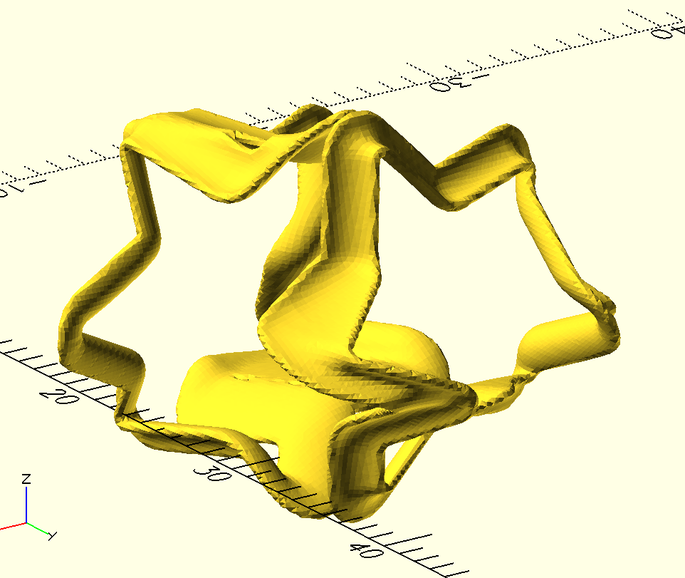

I have uploaded a YT video on creating fillets with marching cubes method.
My library openscad4.py needs to be used for this method.
I used a python library skimage to create marching cubes surface
I find it interesting.
The method takes a little longer but creates smooth surfaces from a list of
points, spaced at a consistent gap.
few more functions that i have written independently to create this are:
offset_solid function
function to find intersection between 2 solids
homogenise function to insert points at consistent gap in the intersection
lines
function to remove degenerate lines which are less than 0.01 length or
whatever specified by user
https://youtu.be/tkN92qB56D4
[image: Screenshot 2025-11-09 at 10.15.58 AM.png]
