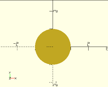

So, for instance, this will generate a one-unit-radius circle (with far
more sides than it needs):
    start = 0;
    end = 360;
    step = 1;
    function f(i) = [ cos(i), sin(i) ];
    points = [
        for (i=[start:step:end]) f(i)
    polygon(points);

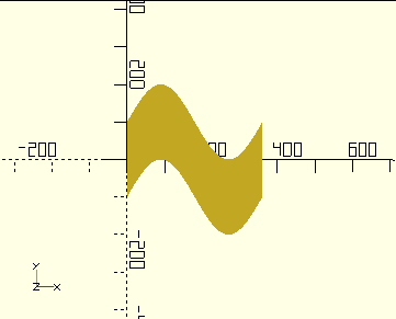

You can get arbitrarily more complex - for instance:
points = [
    for (x=[0:360]) [ x, sin(x)*100+100 ],
    for (x=[360:-1:0])  [ x, sin(x)*100-100 ],
polygon(points);
