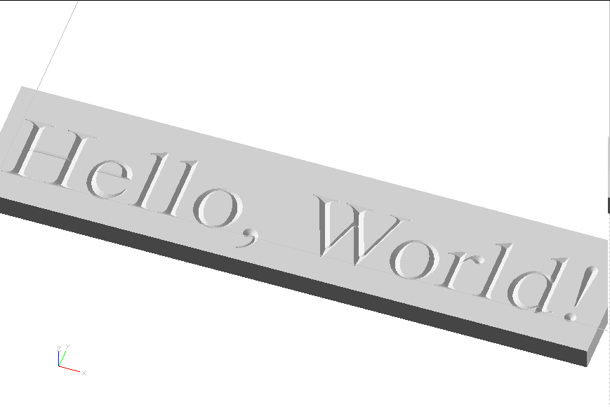

I asked about roof because I used to do engraving like the image below
by differencing away a linear extrude and then using minkowski with a
conical element. It would take quite a while for some of the larger and
more complex shapes. Now, with roof and the new render, it's going to be
crazy quick, and the code is simpler too.
Cheers,
Steve
translate([-2, -4, -3]) cube([80, 18, 3]);
scale([-1, 1, -tan(30)]) roof() scale([-1, 1]) text("Hello,
World!", font="Times New Roman");
